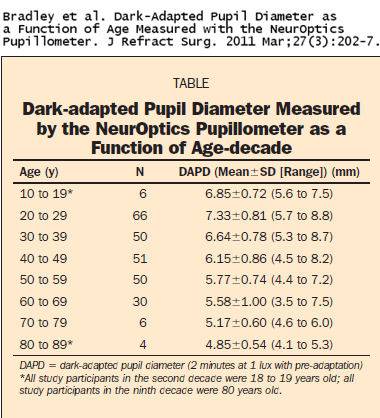

Maximum night adapted pupil diameter shrinks as people get older so you may not benefit as much from a larger "exit pupil". (I'm not saying you are old but you have been around PF for a while.)

I didn't know this! How rapidly does the pupil diameter shrink? I'm 30 (so I'll let you decide whether that's old or not!) - do you think I'd still benefit from the larger exit pupil?
I'm sure it is varied by individual. But IIRC it is about 8mm in children down to about 4mm in the elderly.
Hey! google says: Looks like you are still good to go.
Likes cristo
Thanks for looking this up- very interesting chart. But it look like "it needs more research and more study participants", so says every scientist.
True, and remember that most "scientists" aren't astronomers. Simply placing a participant in a dark room and measuring their pupil diameters after a short time is a really poor approximation, at best. Amateur astronomers can shoot this chart down with ease. It takes me at least 20-30 minutes for my eyes do become dark-adapted enough so that I can get good performance from my scopes. Did the people who compiled the chart invest at least 30 minutes in the dark plus testing on each participant? I doubt it. "Scientific" studies should not be conducted on humans by people with no real experience in physiology. Such studies are unethical, and can result in harm.
JC Bradley, lead author of the study referenced by montoyas, is a licensed ophthalmologist, so it appears safe to assume he has credentialed expertise in ocular physiology. The study did not require 30 minutes of dark adaptation time [more like one minute], hence, also safe to presume no conclusions regarding potential night vision acuity were suggested. I agree that renders it of questionable relevance to this discussion.
