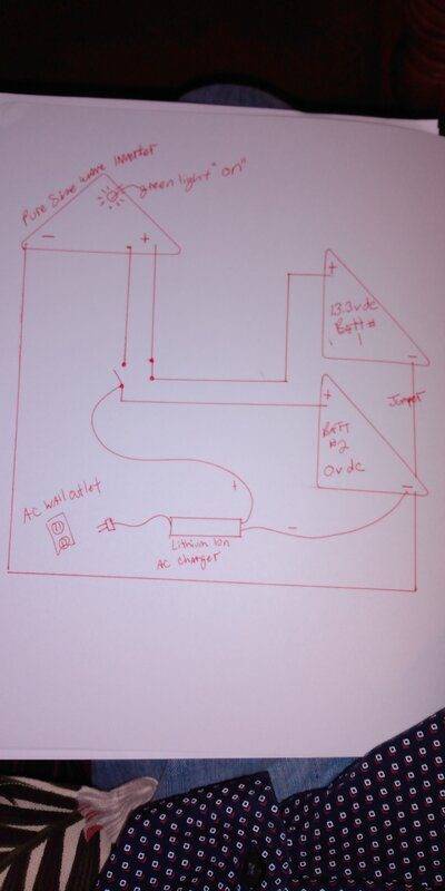

Hello All, I am a licensed electrical contractor and have just now started to build portable ac power generators, would appreciate some opinions on this design.
My thoughts were to operate Batt 1 & Batt 2 Individually, to eliminate the need for a BMS.
However I am not certain this is the most desirable wiring method. I am curious if the Charger will work in this config.
Thank You
looking forward to a professional discussion.
Cody
Welcome to PF.
That looks like it might work.
What capacity batteries will you use?
What is the load on the sinewave inverter?
Hello Baluncore
I am using 23ah Lithium Ion Batteries, each has its own BMS built in.
The Inverter is a 600w, the intended load is end table lamps/standard refrigerator/cordless tool battery recharging/recharge electric bike batteries, small power tools/laptops/phones ...a stand alone unit for emergency power
My concern was is it possible electrons could flow into the fully charged battery and the inverter somehow while charging the depleted battery ? One thought is to build a bigger case and Just install two complete Individual systems.
If that's true, then the two BMS will control how much current is allowed into the batteries, not the inverter power supply. Therefore, the inverter doesn't matter.I'm assuming that BMS means Battery Management System.
Likes Cody1944
I read that current flow in a battery is positive to negative, but electron flow is negative to positive, so will electrons flow from the negative on the charger, to the negative on both Batts, and then flow inside both Batts to the positive posts, causing some type of damage to the fully charged Battery.
So With independent BMS it should not cause any undesired conditions ?
Don't burden your thinking with electron flow. At your level of design, just thing in terms of positive current flow. :smile:

I must be getting punchy in my older years, I just realized If I close both switches my batts are in parallel with each other.
If that was a problem you could use a 10 amp, two pole, two position switch, wired to cross over the batteries.

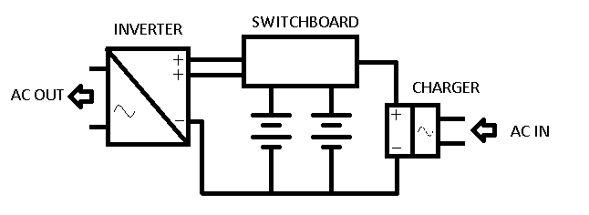

basically, this would be what your circuit would look like if you integrated all those components into one portable unit:
assuming you all had the circuit protections and the approriate groundings in place, that switchboard is basically a black box at the moment, depending on what you want it to do (in your drawing, it's basically just two switches connected between battery and inverter).
basically it's at least a 5-port switchboard whose number of switches and wiring complexity is determined by what kind of switching you'd want to be able to do (you could always screw and then unscrew your charger if you want, but assuming you want to deploy your portable generator, and then charge it after as needed, without further modifications to the circuit, making your own little switchboard would be the way to go.).
so, time for some rules:
1) how do you want your batteries to charge? one at a time? or can your charger handle both at the same time? are both batteries load-carrying, or is one kept only for back-up?
2) do you want the option to operate the charger and inverter at the same time? like charging battery 1 while battery 2 supplies load? or do both of the batteries supply load together at one instance and get charged together afterwards, as needed?
3) anything else you might want the switchboard to be able to do?
cheers!
