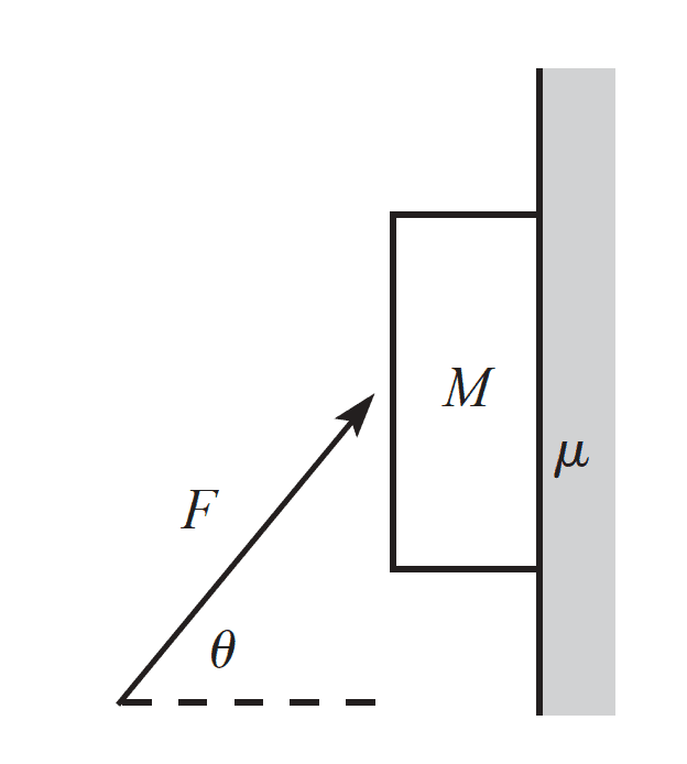

A book of mass M is positioned against a vertical wall. The coefficient
of friction between the book and the wall is μ. You wish to keep
the book from falling by pushing on it with a force F applied at an
angle θ with respect to the horizontal (−π/2 < θ < π/2).
For a given θ, what is the minimum F required?
Sum of horizontal forces =0, sum of vertical forces =0.
The answers show that the static friction between the book and the wall points in the same direction as the vertical component of the applied force. That is, Fsin(θ) + ForceFriction -Mg=0. But why does the friction point in the same direction as the vertical component of F? More generally, if there is more than 1 force acting on an object (as in this case), how can I find the direction of the friction?

Yes. Two up (positive, being added), one down (being subtracted.
Because the wall friction is exerting an upward force on the book, just like the vertical component of F is also exerting an upward force on the book. Only gravity is exerting a downward force on the book, and the two upward forces are just enough to cancel that.
If F is high enough, it will be more than Mg and the friction acting on the book will become negative, but you're asked to find the minimum force, not the maximum.

Yes. I understand what friction is conceptually. But, in this you can't determine the direction of the net applied force since there are two forces two forces acting vertically on the book, Fsin(θ) and Mg and the magnitude of F is unknown. I get that if only Mg were acting on the book, the friction would oppose the downwards movement of the book. But, in this problem, we have Fsin(θ) too. I'm not sure why ForceFriction would point in the same direction as Fsin(θ). The friction could oppose Fsin(θ) or Mg, and I'm not sure which of those it has to oppose. You get what I'm saying?

I think I understand your concern. If we don't know the relative sizes of the other two forces, generally we can't say the direction of friction.
However, as @Halc and @Lnewqban have pointed out in this case, you're after the minimum force ##F## here. This implies that if ##F## were just a tiny bit (infinitesimally) smaller for a given ##\theta##, the book would start slipping down (assuming ##\theta < \frac{\pi}{2}## as shown in the diagram). The friction is going to point upward to oppose this slippage.

Nope. Static friction is whatever is necessary to provide the observed acceleration, in this case zero. Imagine varying the magnitude of ##F## at will, but still keeping the book at rest against the wall. If the vertical component of the pushing force ##F## is equal to the weight, no static friction is needed to keep the book in place. If the vertical component of ##F## is greater than the weight, then static friction will point down so that the net vertical force is zero. Likewise, if the vertical component of ##F## is less than the weight, then static friction will point up so that the net vertical force is still zero. Here we are looking for the minimum value of ##F## which means that static friction must point up and have its maximum value. If ##F## is reduced below that minimum value, the book will slide down.

I beg to differ. If you draw the FBD of the book, there are three forces acting on it, (1) the weight, (2) the contact force at the wall and (3) force ##F## - that's it. Now you can add all three of them vectorially and get the "net" force or you can give names to components like "friction", "normal", "vertical", "horizontal", etc. However, it is a stretch to cherry pick the sum of the vertical components of two of the forces but not the third and call it the net applied force. Also note the wording in the statement of the problem, "##\dots## by pushing on it with a force F applied at ##\dots##" It stands to reason to call ##F## and nothing else the applied force.
