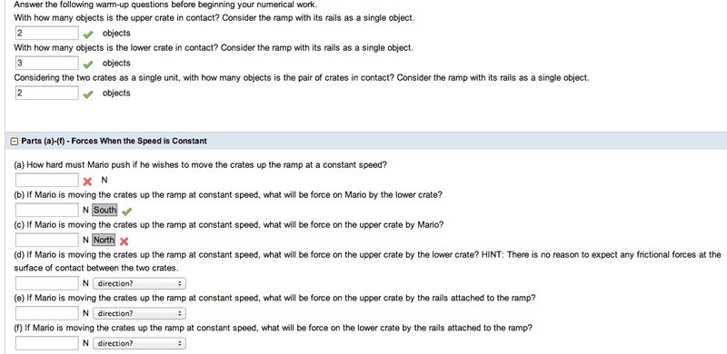

Here are some of the questions asked.
***EDIT, I guessed on the first three questions... ****

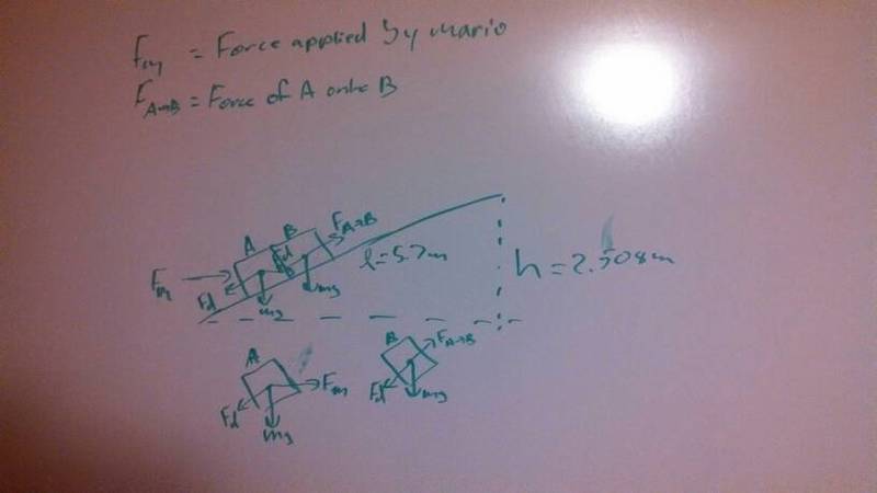

I attached a picture if what you're diagram SHOULD be. Don't take it as absolute though, I'm still not 100% on the intent here.
The diagrams below are individual diagrams of the boxes, and note that I didn't include all the relevant forces nor did I draw the two boxes as a single object, which you should do.
Hopefully this can get you going!
Let us know if you have anymore specific questions concerning the specific solutions.

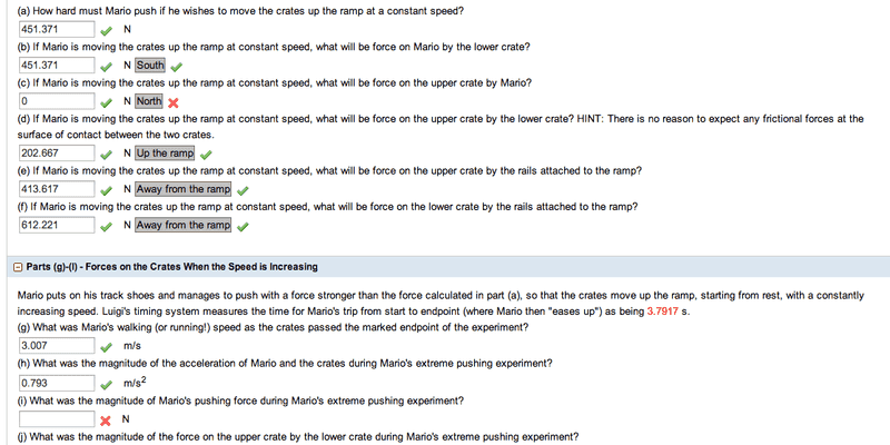

So I managed to find all of the quantities for the crates at constant speed. But now their throwing in some acceleration and I'm kind of lost as to how to approach this.
I've attached some of the questions that have already been asked and also the questions that I'm having trouble with.
Thanks!
drjohn15: how did you find the parts of the first part I am stuck on this part now?
Apologies for the delayed response. In having trouble viewing those questions but you asked about acceleration, so I can say this: F=MA, if you've found the force mass is given, acceleration easily follows. Just keep in mind the force and acceleration are vectors and the acceleration is ALWAYS in the direction of the Force and vice versa. I'll take a better look at the questoons later this evening and have a more specified response if you need it.
