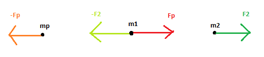

Is this free body diagram correct?
Fp is the original pushing force, coming from object "mp" acting on "m1". -Fp is reacting force on that, coming from object "m1" acting on "mp".
F2 is the pressing force coming from object "m1" acting on "m2". -F2 is the reaction force on that, coming from object "m2" acting on "m1".

The diagrams for m1 and m2 look good. (You can take the minus sign off of -F2. The direction of the arrow will determine the sign.)
There may be other forces acting on "mp", but we don't care. We are only analyzing m1 & m2.
