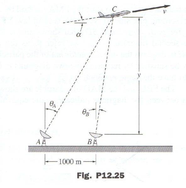

the plane C is being tracked by radar stations A and B. At the instant shown,
the triangle ABC lies in the vertical plane, and the radar readings are θA=30o,
θB = 22o, θA(dot) = 0.026rad/s and θΒ(dot) = 0.032rad/s. Determine (a) the altitude y; (b) the speed v; and (c) the climb angle α of the plane at this instant
I guess I can find (a) from trogonometry. Any hints for part (b)?

I'd draw a good picture and think long and hard about related rates.
Solve part a) keeping everything symbolic - do not plug any of the given numbers in.
That will give you an equation for y in terms of the two angles and the distance between the stations.
Get another equation for the x coordinate.
With those two equations, how might you get an equation for velocities?

Posting the picture, rather than the thumbnail makes the problem clearer and may encourage more help,
