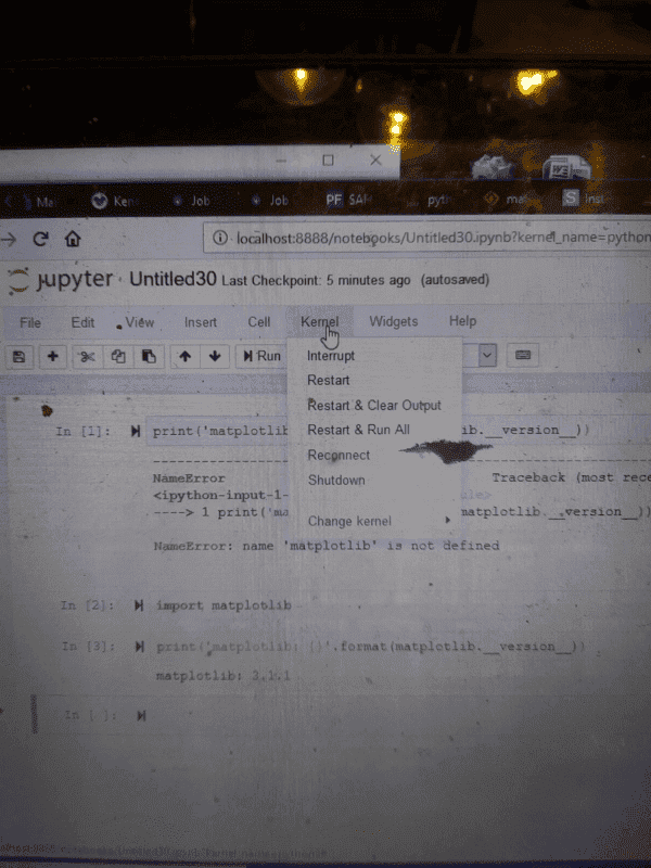

Jupyter Notebook is an IDE from Anaconda, it has its own kernel, which you may restart:
Jupyter Notebook is not really an IDE, it is according to its own web site "an open-source web application that allows you to create and share documents that contain live code, equations, visualizations and narrative text". This has many implications, two of which that are relevant here (noting that you are in a Windows context) are:
  • The source "files" for a project are not individual files, they are stored in a single project file with the .ipynb extension. So when you want to save an edit, the Jupyter process that you have asked to save must be able to gain write permission to the project file which it can only do if no other process has a write lock.
  • You use a browser to interface with the Jupyter process; if you close the browser tab the Jupyter process is still running - or even worse, may subsequently crash, making it very difficult to detect that it still has a write lock on the open project file.
