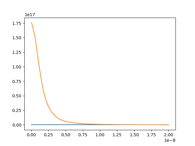

I want to plot v vs t, but the code doesn't return enough points for plotting
Hi, I have this code that solve the equation of motion of a relativistic electron.

a = solve_ivp(d2vdt2,(0, 20*10**(-9)), (0,e*E/m),"Radau")
The problem is I want to plot v vs t, but I don't know how get lists of v and t from the function. If I have the function return v and t, then the code won't loop enough times to get enough data points for plotting. The results of v and t printed out in the function are correct, but I don't know how to make lists of them as the function resets every time it is called by solve_ivp, and the values of v and t from the previous iteration are gone. Thanks!

Is the graph should be something like this ?
That is the acceleration vs time. I need velocity vs time. I already got the solution now. Thanks for replying.
Have you read the documentation for the function you are using? A quick search suggests that your returned value a should contain what you are looking for as members called t and y.
