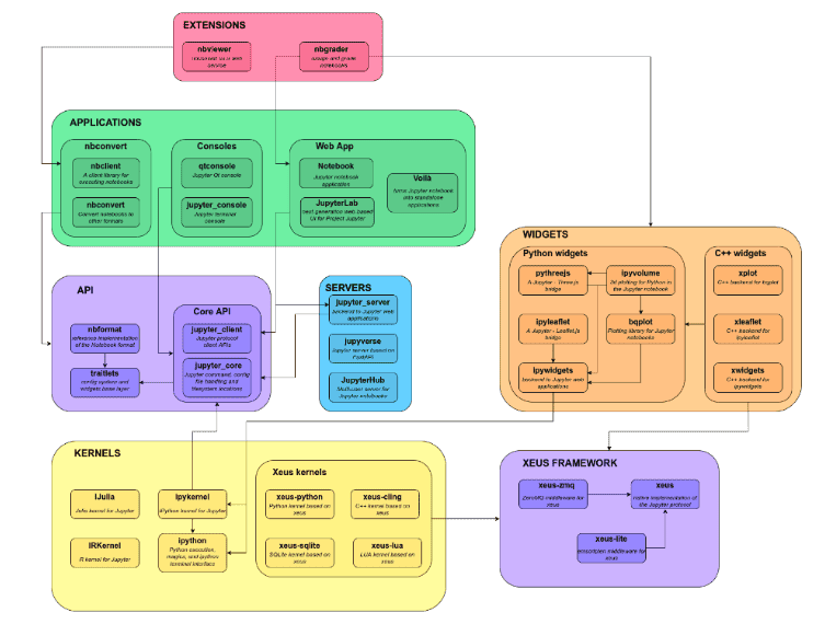

A while back we talked about how Jupyter notebook works and you truly help a lot in that discussion (always do). Jupyter notebook is a prime example of client-server application: the client is the browser, there is a local web server, and there is the ipython kernel (which I envision like a python interpreter with more wrapping around and whose job is to process the python code in the notebook cells).
Jupyter notebook is not necessarily designed to be used by multiple users...In my case, I have a machine and I am the sole user...
Back to the mechanics, the Jupyter server talks to the browser (using web protocols TCP/IP) and also talks to the Ipython kernel (using a ZMTP protocol). The Ipython kernel (which existed before Jupyter) is really like a "specialized python interpreter" that can receive a jupyter notebook (a json file with markdown, graphs, etc.), process the Python code inside its cells, send the results back the sever which sends it to the browser...The browser URL shows localhost:8888 meaning that the browser is a process at port 8888...Or are those the IP address and port of the jupyter server? The localhost is the alias for 127.0.0.1...My computer has a different local IP though. Shouldn't all process share the same IP, since they are on the same machine, but different ports?
Another more detailed diagram of what is happening under the hood:
I see the yellow box with the different possible kernels (depends on the programming language we use). The blue box comprises different possible server options...What do the purple box and green box represent in the relation to the browser (client)?
