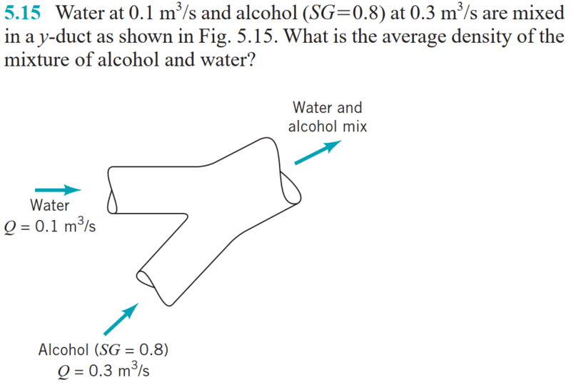

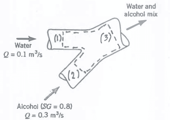

Q: Why ρ1≠ρ2≠ρ3, but the answer says ρ1Q1+ρ2Q2=ρ3Q3 can be simplified into Q1+Q2=Q3?
The summation of the entering volumetric flows must be equal to the single leaving volumetric flow.
Otherwise, compression or expansion would be happening within the control volume indicated in dashed lines.
But those flowing substances are in liquid form, which are considered incompressible.
Imagine that we are doing the mixing of two volumes of liquids by hand in one second.
The mix will occupy a volume of 0.1 + 0.3 = 0.4 cubic meters, but its density will be a value between 1 SG and 0.8 SG.
As we are mixing 1 part of water and 3 parts of alcohol, the mix density should be closer to 0.8 SG.

I can understand it intuitively, but I hope to find a mathematical derivation as well. Currently, I have only reached the divergence theorem for cases with equal densities.
Currently in search of a proof for the divergence theorem with varying densities.
I don't think you do, because (assuming the liquids are incompressible and there are no leaks), the only thing to understand is 0.1 + 0.3 = 0.4!
Think of a litre of liquid as a ball. If during an interval you have 1 yellow ball and 3 red balls entering the system on the left, how many balls will exit the system on the right (assuming the balls are not being compressed or lost)?
No, the densities do not vary, they are constant. Different but constant. And the proof for different but constant densities is the same as the proof for equal densities.
No, it cannot be simplified to that. The two statements are independently true. One represents conservation of mass, while the other represents conservation of total volume. The second is true because the liquids do not interact in a way that would make the total volume anything other than the sum of volumes (assuming they enter at the same temperature).
Is this true for any two liquids? Can one liquid dissolve in another?
Quite possibly, but I would say it is unlikely for the two given here. Certainly the author doesn’t think so.

I don't think continuity of volumetric flow should be taught, since eventually it will have to be unlearned (systems with varying temperature and / or pressure). Just my opinion.
