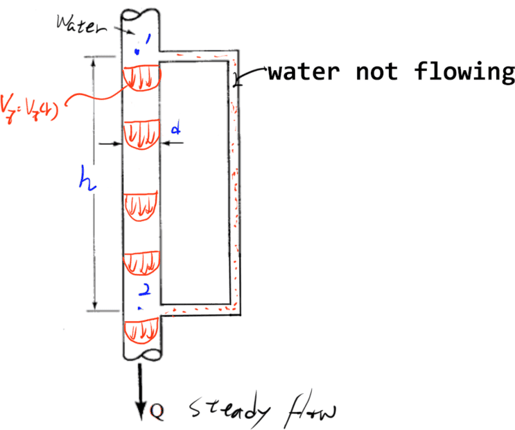

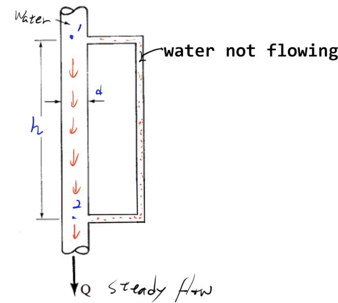

To determine P2
hydrostatic pressure and energy conservation equation.
Please help me to understand which ans is correct.
To determine the ##P2##.
h_{LM}\ne 0

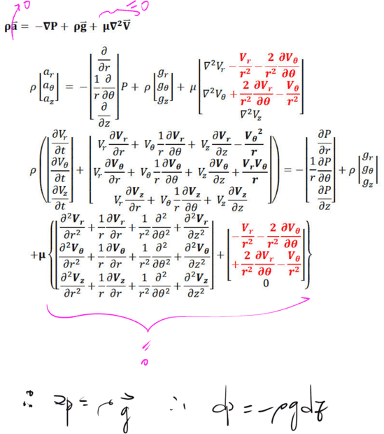

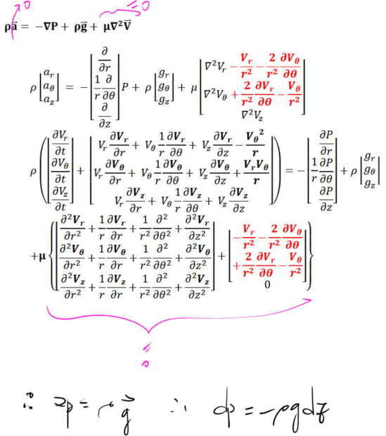

Method 1:
$$dP=\frac{\partial P}{\partial x}dx+\frac{\partial P}{\partial y}dy+\frac{\partial P}{\partial z}dz$$$$\phantom{\rule{0ex}{0ex}}\rho \overset\rightharpoonup{a}=-\triangledown p+\rho \overset\rightharpoonup{g}\phantom{\rule{0ex}{0ex}}$$$$\triangledown P=\rho (\overset\rightharpoonup{g}-\overset\rightharpoonup{a})$$$$\because steady flow \therefore \overset\rightharpoonup{a}=0$$$$\therefore \triangledown P=\rho \left(\overset\rightharpoonup{g}\right)$$$$\therefore\triangledown P=\rho\left(\overset\rightharpoonup g\right)=\left\langle0,0,-g\right\rangle=\frac{\partial P}{\partial x}dx+\frac{\partial P}{\partial y}dy+\frac{\partial P}{\partial z}dz$$$$dp=-\rho gdz=-\gamma _wdz$$
$$P2=P1+\gamma _wh...........\left( ans1 \right)$$

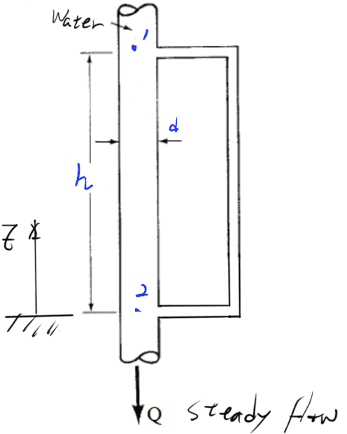

Mtheod 2:
Energy Conservation Equation.$$\frac{{P}_{1}}{\gamma }+\frac{{{V}_{1}}^{2}}{2g}+{Z}_{1}=\frac{{P}_{2}}{\gamma }+\frac{{{V}_{2}}^{2}}{2g}+{Z}_{2}+{h}_{LM}$$$$
Q=AV_1=AV_2\
\therefore V_1=V_2
\therefore \frac{P_1}{\gamma _w}+Z_1=\frac{P_2}{\gamma _w}+Z_2+h_{LM}
\frac{P_2}{\gamma _w}=\frac{P_1}{\gamma _w}+Z_1-Z_2-h_{LM}
P_2=P_1+\gamma _w\left( Z_1-Z_2 \right) -\gamma _w\left( h_{LM} \right)
\ \ =P_1+\gamma _w\left( h \right) -\gamma _w\left( h_{LM} \right) ................\text{(ans2)}

If water isn’t flowing in the side branch, the differential pressure across 1-2 is 0. So what does that imply about the head loss given the change in elevation?
Energy loss is the loss caused by friction in the intermediate pipeline as the fluid flows through the pipe.
Yeah, I get that. If there is viscous loss in the pipe, then for steady flow method 2 is correct. What is the question? I suspect you are supposed to determine ##h_{LM}##?
If that is the case, like I said. The differential pressure across 1-2 is 0. That has implications for the head loss from 1-2, given the change in elevation from 1-2.

When you are diving into this kind of analysis, I'm on very thin ice. But, if there is viscous loss, there is shear stress acting on the fluid element.
There is no shear "force term" in what you have presented?
So, if there is frictional loss in the pipe flow, then
\rho \overset{\rightharpoonup}{a}=-\triangledown p+\rho \overset{\rightharpoonup}{g}
is not true?
this equation omits the viscous friction term.

In the main applying COE:
##v_1 = v_2##
##z_2 = 0## elevation datum
$$ \frac{P_2}{\gamma} = \frac{P_1}{\gamma} + z_1 - \sum_{1 \to 2} h_L$$
Where, ##\sum_{1 \to 2} h_L > 0##
Applying COE across the branch:
##v_1 = v_2 = 0##
## \sum_{1 \to 2} h_L = 0 ##
$$ \frac{P_2}{\gamma} = \frac{P_1}{\gamma} + z_1 $$
For parallel sections the loss ## h_{main} = h_{branch}##
We also have to satisfy continuity.
Likes tracker890 Source h
erobz said:
We are getting contradiction somehow?
##v_1 = v_2##
##v_1 = v_2 = 0##
I\ think\ h_{LM}\ne 0\ is\ not\ correct\ in\ this\ example,\ h_{LM}\ne 0\ must\ be\ changed\ to\ h_{LM}=0.
My belief is the contradiction is hidden in the assumption of the problem statement, that the flow in the side branch is 0.
If you apply COE (using what I shown above) without invoking the "no flow" condition in the branch the following is the system of equations:
$$ \frac{P_2}{\gamma} = \frac{P_1}{\gamma} + z_1 - \sum_{1 \to 2} h_{L_m}$$
$$ \frac{P_2}{\gamma} = \frac{P_1}{\gamma} + z_1 - \sum_{1 \to 2} h_{L_{b}}$$
That system reduces to the established result:
$$ \sum_{1 \to 2} h_{L_m} = \sum_{1 \to 2} h_{L_b}$$
$$ k_{m} \frac{Q_{m}^2}{A_{m}^2 2g } = k_{b} \frac{Q_{b}^2}{A_{b}^2 2g }$$
Let the total flow into the node be known and equal to ##Q##. It follows that:
$$ k_{m} \frac{(Q - Q_b)^2}{A_{m}^2} = k_{b} \frac{Q_{b}^2}{A_{b}^2}$$
$$ \implies Q^2 - 2 Q Q_b + \left( 1 - \left( \frac{A_m}{A_b} \right)^2 \frac{k_b}{k_m} \right) Q_b^2 = 0 $$
I get the following solution:
$$ Q_b = Q \left( \frac{1+ \frac{A_m}{A_b} \sqrt{ \frac{k_b}{k_m} } }{ 1 - \left( \frac{A_m}{A_b} \right)^2 \frac{k_b}{k_m} } \right)$$
So if you take ##k_m, A_m > 0## you shouldn't find ## Q_b \to 0 ##, unless ##Q = 0##, or in the limit as ## k_b \to \infty, A_b \to 0 ##.

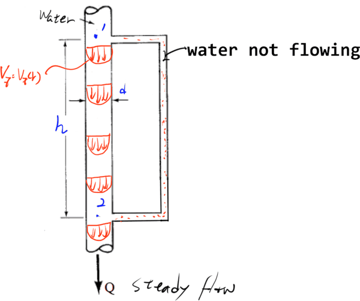

For laminar flow, the force balance ;on the fluid between points 1 and 2 reads:
$$P_1\left(\frac{\pi D^2}{4}\right)+\rho\left(\frac{\pi D^2}{4}\Delta z \right)g=P_2\left(\frac{\pi D^2}{4}\right)+\tau_w(\pi D \Delta z) $$where ##\tau_w## is the viscous shear stress at the wall: $$\tau_w=\left(\frac{32Q}{\pi D^3}\right)\eta$$where Q is the downward volumetric flow rate and ##\eta## is the viscosity. What does this give you when you divide both sides of the first equation by ##\left(\frac{\pi D^2}{4}\right)## and substitute the 2nd equation?
It gives me two different results for ##P_2## depending on which branch I take in going from ##1 \to 2##.
In the OP ##Q_m>0## in the main and in the branch ##Q_b = 0##. I don't care what flow regime we are working in, that is an issue.
The faulty assumption in the problem statement leading to the contradiction is that ##Q_b = 0##.
Yes. That's right. It only works out if the fluid is inviscid.

For viscous flow, the flow in the branch is related to the flow in the main channel by $$Q_B=\left(\frac{D_B}{D}\right)^4Q$$So, for a diameter ratio of 0.1, the flow ratio is 0.0001.
