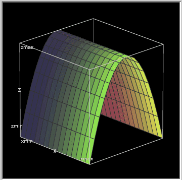

$\text{Evaluate } $
\begin{align*}
I&=\iiint\limits_{E} x^2 e^y dV
\end{align*}
$\text{where E is bounded by the parabolic cylinder} $
\begin{align*} z&=1 - y^2 \end{align*}
$\text{and the planes
$z=0, x=1,$ and $x=-1$}\\$
Let's first look at the volume in question:
What order of integration makes sense to you?
Sorta maybe??$\displaystyle\int_{0}^{1 - y^2
}\int_{-1}^{1}\int_{x_l}^{x_u} x^2 e^y \,dx \,dy \,dz$
What happens when you try iterating in that order, and I assume you mean:
$$I=\int_0^{1-y^2}\int_{-1}^1\int_{-1}^1 x^2e^y\,dx\,dy\,dz$$
Your "inside integral", with respect to z, has limits that are functions of y. So the integral will be a function of y not a number.
Also "the parabolic cylinder z= 1- y^2" does not bound a finite region. Did you mean "in the first octant"?
how can the "inside integral" be in respect to z?
Yes, that should have been "outside". Thanks for pointing that out.
I was hoping you would discover on your own that with the integral written this way you would obtain a function of $y$, rather than a numeric result. Anyway, I would recommend:
$$I=\int_{-1}^1\int_{-1}^1\int_{0}^{1-y^2}x^2e^y\,dz\,dx\,dy$$
It really makes little difference as long as $z$ is not the outermost variable. Can you see any symmetries you can use to simplify the integral? This question is directed to the OP only...;)
