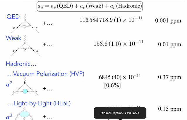

The bit that my screenshot obscured is HLbL = "92(18) × 10−11" which is a 20% relative uncertainty.
The screenshot above is from an April 7, 2021 Zoom press conference from Fermilab announcing a new muon g-2 measurement at Fermilab that was derived from T. Aoyama, et al., "The anomalous magnetic moment of the muon in the Standard Model" arXiv (June 8, 2020), with the same lead author of the paper in question.
You can use the muon g-2 measurement to measure the QED coupling constant to a precision of 1 part per million (or less precisely), since it is a pure QED theoretical calculation in which the QCD and weak force contributions can be ignored as negligible up to that level of precision. But even then, you need to do the QED calculation to something like five or six loops to convert the experimentally measured value of muon g-2 to the QED coupling constant's value, which is a non-trivial calculation (although far simpler than the parallel QCD calculations).
If you want to determine the QED coupling constant from experiments more precisely than you can with muon g-2 (the current experimentally measured value is roughly 100 times more precise than that), you need to find an experiment with less QCD and weak force noise than muon g-2 and do a theoretical calculation of its value in terms of the QED coupling constant for that experiment.
