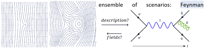

Can this connection be taken to field theories - can we see QFT as Feynman ensemble of fields?
Nowhere differentiable ones or more physical?
With concrete field configurations corresponding to each Feynman diagram?
Generally: what are the similarities and differences between classical and quantum field theories?

Yes, in QFT the path integral is over field configurations.

Great, I also would like to think so, but am not completely certain if it is appropriate (?)
Feynman diagram is kind of higher abstraction level - there should be e.g. ensembles of EM field configurations behind charged/magnetic dipole particles in Feynman diagrams (?)
So maybe we can also translate e.g. between methods of handling infinities between them?

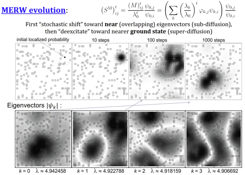

Here is MERW ( https://en.wikipedia.org/wiki/Maximal_entropy_random_walk - Boltzmann path ensemble) evolution example in defected lattice - it sees excited states, but they are not stable as in Schrodinger - it goes to stationary density as in ground state Schrodinger:

Regarding Feynman ensembles, indeed phase makes it more complicated, classical mechanics is obtained in approximations like the saddle-point method, van Vleck determinant.
Regarding excited states in euclidean/imaginary time, statistical physics interpretation, I have mentioned that they indeed are there - but as metastable, no longer stable.
Feynman ensemble leads to hyperbolic PDEs with eigenvalues on unitary circle, while Boltzmann to parabolic PDEs with eigenvalues on real axis.
Like in the MERW evolution diagram above, starting close to excited state, the density will first localize there, but finally it will "deexcite" to the ground state.
It is different than e.g. in Schrodinger, where excited states are stable - excited atom requires external perturbation to deexcite there.
