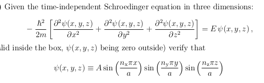

Give an expression for the number of states, N , having energy less than some given E .
Assume N >> 1.
\psi (x,y,z) \equiv A
\sin{\left(\frac{n_x \pi x}{a} \right)}
\sin{\left(\frac{n_y \pi y}{a} \right)}
\sin{\left(\frac{n_z \pi z}{a} \right)}
Hi, so I'm having trouble with a homework problem where it asks me to find the number of states with an energy less than some given E.
From this, I was able to work out the energy E to be
E = \frac{\hbar^2}{2m} \frac{\pi^2}{a^2} \left(
n_x^2 + n_y^2 + n_z^2
\right)
and also find the energy of the ground and first excited states respectively by replacing (nx,ny,nz) with (1,1,1) and (1,1,2).
I've attempted to rearrange the equation as below, but am not really sure about where to go next.
n_x^2 + n_y^2 + n_z^2 = \frac{2m E a^2}{\hbar^2 \pi^2}
Any guidance would be appreciated. Thanks in advance!

They say to consider the case ##N \gg 1##. In that limit, the integer ##n_x,n_y,n_z## can be thought as forming a dense set, so think of them as ##x,y,z##. Now, does the expression ##x^2 + y^2 +z^2## remind you of something?

That would be a sphere at the origin with a radius of $$\sqrt{\frac{2 E m a^2}{h^2 \pi^2}}$$. I'm not too sure what to do with this, could it be something with the density?
The idea is that if you have a state ##n_x, n_y, n_z##, then you could look at that as a point in 3D space. Then it's a question of how many points lie within a given volume.
