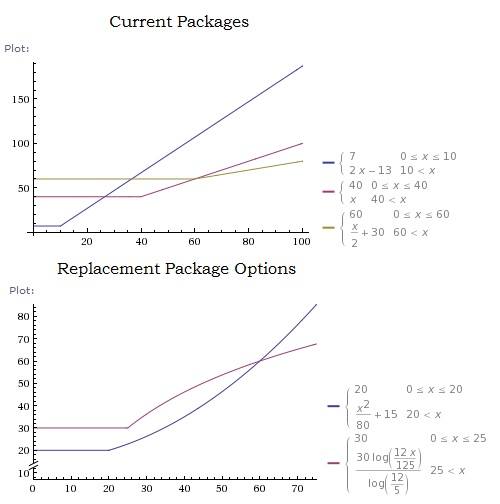

Task 1: Graph the current pack options -Appetizer, Quest and Voyager.
The functions that model these packages will need to be piecewise defined, since the cost remains constant from 0 gigabytes used up to and including a given "included gigabytes usage" number, and then for additional usages, the coast increases linearly at a given rate. We will let the independent variable $x$ be the usage in gigabytes, and so the dependent variables will be the cost associated with each package.
Appetizer: monthly access fee \$7, included gigabytes 10, cost per additional gigabyte \$2.
For this package, we will let $A(x)$ represent the cost. We see that we need $A(x)=7$ for $0\le x\le10$. When $10<x$, we know the slope of the line is 2, and it begins at the point (10,7), and so using the point-slope formula, this portion of the function is:
$$A(x)-7=2(x-10)$$
$$A(x)=2x-13$$
And so we may then write the piecewise definition of the cost function as:
$$A(x)=\begin{cases}7 & 0\le x\le10\\ 2x-13 & 10<x \\ \end{cases}$$
Quest: monthly access fee \$40, included gigabytes 40, cost per additional gigabyte \$1.
For this package, we will let $Q(x)$ represent the cost. We see that we need $Q(x)=40$ for $0\le x\le40$. When $40<x$, we know the slope of the line is 1, and it begins at the point (40,40), and so using the point-slope formula, this portion of the function is:
$$Q(x)-40=x-40$$
$$Q(x)=x$$
$$Q(x)=\begin{cases}40 & 0\le x\le40\\ x & 40<x \\ \end{cases}$$
Voyager: monthly access fee \$60, included gigabytes 60, cost per additional gigabyte \$0.50.
For this package, we will let $V(x)$ represent the cost. We see that we need $V(x)=60$ for $0\le x\le60$. When $60<x$, we know the slope of the line is $\dfrac{1}{2}$, and it begins at the point (60,60), and so using the point-slope formula, this portion of the function is:
$$V(x)-60=\frac{1}{2}(x-60)$$
$$V(x)=\frac{1}{2}x+30$$
$$V(x)=\begin{cases}60 & 0\le x\le60\\ \frac{1}{2}x+30 & 60<x \\ \end{cases}$$
To get a plot of the three cost functions, enter the following command at W|A:
piecewise[{{7,0<=x<=10},{2x-13,10<x}}],piecewise[{{40,0<=x<=40},{x,40<x}}],piecewise[{{60,0<=x<=60},{x/2+30,60<x}}] where x=0 to 100
Task 2: Graph the two replacement pack options - option 1 - quadratic model, option 2 - logarithmic model.
We are implicitly given two points through which both curves must pass.
For the quadratic model, we know the quadratic portion of the function begins at (20,20), but must also pass through the point (60,60), since this is the cost for Voyager customers at 60 gigabytes.
So, using:
$$f(x)=ax^2+b$$
we obtain the 2X2 linear system:
$$f(20)=a(20)^2+b=400a+b=20$$
$$f(60)=a(60)^2+b=3600a+b=60$$
Now we may determine the values of the parameters $a$ and $b$. Subtracting the first equation from the second, we eliminate $b$ and get:
$$3200a=40\,\therefore\,a=\frac{1}{80}$$
Now, substituting for $a$ into the first equation, we find:
$$400\cdot\frac{1}{80}+b=20\,\therefore\,b=15$$
If we let the quadratic model be $q(x)$, then we may state:
$$q(x)=\begin{cases}20 & 0\le x\le20\\ \frac{1}{80}x^2+15 & 20<x \\ \end{cases}$$
For the logarithmic model, we are told it must pass through the points (25,30) and (60,60).
Hence, using:
$$f(x)=a+b\ln(x)$$
we obtain the system:
$$f(25)=a+b\ln(25)=30$$
$$f(60)=a+b\ln(60)=60$$
Subtracting the first equation from the second, we eliminate $a$ to obtain:
$$b\ln(60)-b\ln(25)=30$$
$$b\ln\left(\frac{60}{25} \right)=b\ln\left(\frac{12}{5} \right)=30$$
$$b=\frac{30}{\ln\left(\frac{12}{5} \right)}$$
Substituting for $b$ into the first equation, we find:
$$a+\frac{30\ln(25)}{\ln\left(\frac{12}{5} \right)}=30$$
$$a=30-\frac{30\ln(25)}{\ln\left(\frac{12}{5} \right)}=30\left(1-\frac{\ln(25)}{\ln\left(\frac{12}{5} \right)} \right)$$
Thus, the logarithmic portion of the function is:
$$f(x)=30\left(1-\frac{\ln(25)}{\ln\left(\frac{12}{5} \right)} \right)+\frac{30}{\ln\left(\frac{12}{5} \right)}\ln(x)=30\left(1+\frac{\ln\left(\frac{x}{25} \right)}{\ln\left(\frac{12}{5} \right)} \right)$$
If we let the logarithmic model be $\ell(x)$, then we may state:
$$\ell(x)=\begin{cases}30 & 0\le x\le25\\ 30\left(1+\frac{\ln\left(\frac{x}{25} \right)}{\ln\left(\frac{12}{5} \right)} \right) & 25<x \\ \end{cases}$$
To obtain a plot of the two models at W|A, enter the command:
piecewise[{{20,0<=x<=20},{x^2/80+15,20<x}}],piecewise[{{30,0<=x<=25},{30(1+ln(x/25)/ln(12/5)),25<x}}] where x=0 to 75

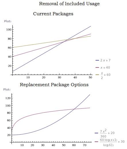

Task 5: Model the effects on the cost to the customer of removing the "included gigabytes usage."
We are told that "the customer would pay the monthly access fee plus the cost of each gigabyte used."
So, for the current linear models, the $y$-intercept for each function is the monthly access fee, and the slope is the cost per additional gigabytes used. Hence, we have:
$$A(x)=2x+7$$
$$Q(x)=x+40$$
$$V(x)=\frac{1}{2}x+60$$
To see a plot of these functions, at W|A, enter the command:
y=2x+7,y=x+40,y=(1/2)x+60 where x=0 to 50
For the quadratic and logarithmic replacement models, we may use the fact that at $x=0$, the cost function is equal to the monthly access fee, and at $x=60$, we want $f(60)=V(60)=90$.
Quadratic model:
$$f(x)=ax^2+b$$
$$f(0)=b=20$$
$$f(60)=a(60)^2+b=3600a+20=90\,\therefore\,a=\frac{7}{360}$$
Thus, we find:
$$q(x)=\frac{7}{360}x^2+20$$
Logarithmic model:
Because $\ln(0)$ is undefined, let's use:
$$f(x)=a+b\ln(x+1)$$
$$f(0)=a=30$$
$$f(60)=a+b\ln(61)=30+b\ln(61)=90\,\therefore\,b= \frac{60}{\ln(61)}$$
And so we have:
$$\ell(x)=30+\frac{60\ln(x+1)}{\ln(61)}= 30\left(1+\frac{2\ln(x+1)}{\ln(61)} \right)$$
y=(7/360)x^2+20,y=30(1+(2ln(x+1))/ln(61)) where x=0 to 75
