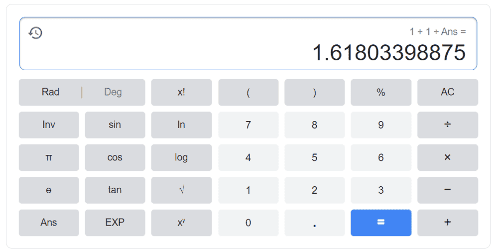

But now, if we follow a process in any general calculator by entering
1+1/Ans
into the calculator repeatedly, we always reach this particular number as shown,
Now obviously we cannot do this process for when the value of Ans is set to 0.
But other than that, no matter what the value of answer we choose,
for all real numbers if we repeatedly do this process on any calculator,
we always reach the above mentioned number.

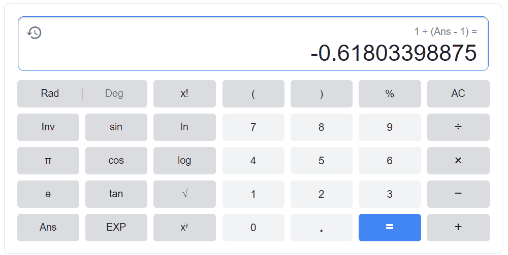

Now this got me thinking and I tried to manipulate the original equation to something like this (don't ask me why I did this cause even I don't know that, I was just playing around with random inputs like these when the result for this input surprised me),
x=1/(x-1)
This equation is exactly same as our original equation with the only difference being that in the original equation we cannot have the value of x as 0 and in the modified version, x should not be equal to 1. So now let's do another process (repeatedly) in the calculator,
1/(Ans-1)
again by the same logic we can see that the process which we are doing, actually looks like the equation,
Ans=1/(Ans-1)
Only difference this time is that now we cannot set the value of answer as 1 or 2.
Other than that, for all real values of Ans, this time we reach this particular number,
And this number is exactly equal to the other value of x in our original equation which is (1-√5)/2
So that is my question, why does the calculator have a favorite root for a particular function when more than one values satisfy the equation?

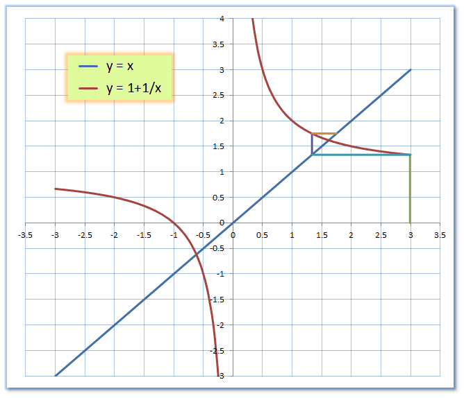

You want to be careful with generalizations.
Basically what you are doing is you solve x = x + 1/x by a well-known procedure called successive substitution: you solve x = f(x) by starting at some x0 and calculating f(x0). This result is your next guess, x1 and you calculate x2=f(x1).
Etc. until your x doesn't change any more.
Example:
x0 = 3
x1 = 1.333
x2 = 1.747
x3 = 1.571 etc converging to (1+√5)/2
and sure enough, x0 = -3 brings you to the same point.
BUT do you see which starting values take you to the alternative solution ?
Hint: It's only a small range. But your generalization 'no matter what the value of answer we choose' is definitely incorrect !
Advanced question: can you also see what kind of functions/starting value will not converge with this method ?

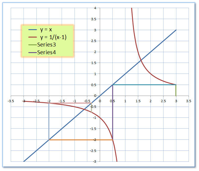

Here you see the situation for x = 1/(x-1)
Again: can you find which starting values take you to the alternative solution ?
It looks like,
for the first graph only the input (1-√5)/2 will get us to the alternate solution,
and similarly for the second graph only (1+√5)/2 gives us exactly the intersection between the lines y=x and y=1/(x-1),
anything other than that seems to slowly-slowly move away from (1+√5)/2.
That's when I tried to manually trace straight lines on the given graphs. So, I'm not sure but when I was trying this process on the calculator I did end up on the alternate solution every-time I started with the alternate solution.
edit: I will surely try this on GeoGebra as well.

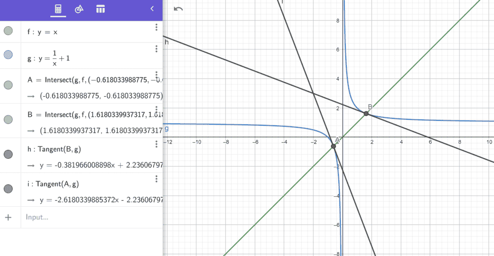

You are absolutely right !
Bad on my part (shouldn't do this off the top of my head).
Has to do with the slope of f(x) -- more googling (or diving into the books :smile:) required .

This iterative method for solving x = f(x) will converge if there is a region around the root in which |f'(x)| < 1.
Likes SammyS

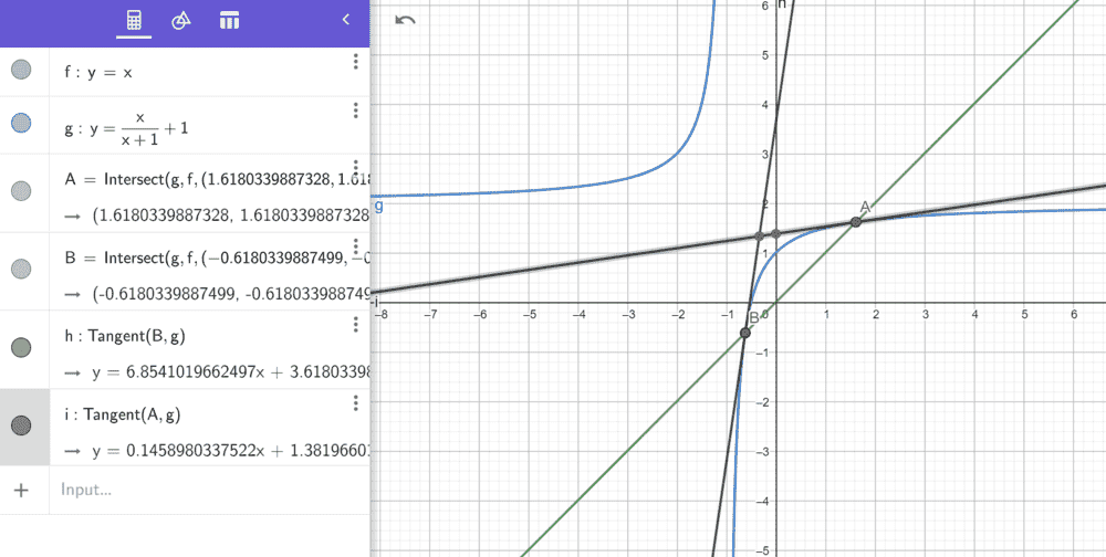

I was plotting the same function by rearranging its terms, on GeoGebra, and pretty much everyone of them followed your rule
these above two were the original ones which I mentioned in the post,
And these two below were two similar cases which followed your rule,
I also found a few interesting cases as well like these below,
here we can see that,
|f'(x)| > 1 in the regions around both the roots,
so in these two cases our method should not work and it should not converge.
But there were some values for which our function didn't blow up to infinity, but instead it was dancing around two particular values.
Why is that happening?
