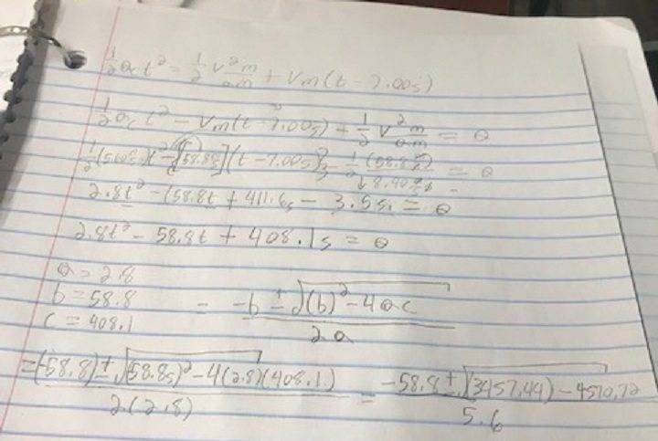

I was following all the way up to using the quadratic equation for this problem...(please see img for a more detailed attempt at a solution.)
So I may have simplified incorrectly here:
243816
but I came up with
2.8t^2-(58.8)t+408.1=0
but when filling in
a=2.8
b=58.8
c=408.1
in the quadratic equation to find "t" The root would be negative. So I'm stuck. The answer to the example problem is 4.44 s and t 16.6 s which 16.6 would be the correct answer for t, I just am stuck at how they got these answers from the quadratic equation.
In the final quadratic b = -58.8, but that does not fix the problem.
The problem is in your original equation that is dimensionally incorrect. The left side has units of length and the right side has units of time.

Hi kuruman, thanks for your reply. Unfortunately that still makes the root in the quadratic equation negative because
[tex]\frac{{ - b \pm \sqrt {{{( - 58.8)}^2} - 4ac} }}{{2a}}[/tex]
and I calculated -4(a)(c)= 4570.72 which would equal (-1113.28) under root.
The problem is in your original equation that is dimensionally incorrect. The left side has units of length and the right side has units of time. I don't know what it is supposed to represent, but you need to start with equations one for the position of the car at any time t and a second for the position of the motorcycle at any time t. Then say that there is a particular time ##t_c## at which the car catches up. At that time the two expressions for the positions must be equal.

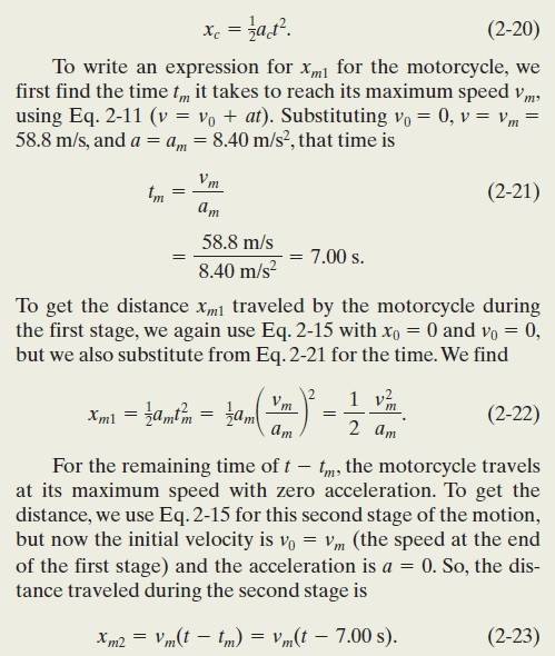

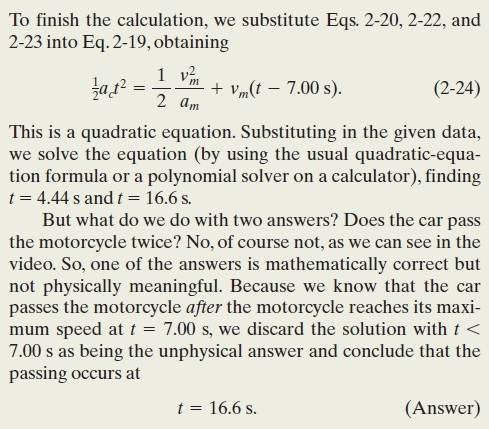

The equation is unlikely to be incorrect as it came from the textbook's example problem.
243818
You copied it incorrectly. Try again.

Wouldn't you want to put it in the form = 0 before you put a,b,c into quadratic?

I don't understand why you have posted the textbook image again. The error is not there; the error is in the copy you made in post #1.
Likes Selectron09
I posted that so you would know what they are referring to by 2-20-2-23

However, looking at your handwritten working you may have used the correct version and only made the mistake in typing the Relevant Equation in post #1. Give me a moment to check further.

Ok. The error you made in post#1 is that you left out a vm in the last term.
But I think your problem is that the two questions are not quite the same. Does the car reach the motorcycle while it is still accelerating or only after having reached its maximum speed?

As pointed out by others, your Relevant Equation(s) is incorrect. It's missing a vm
It should be: ##\quad \dfrac{1}{2}a_c {t^2} = \dfrac{1}{2}\dfrac{{v_m^2}}{{a_m}} + v_m(t - 7.00)##
(I also fixed the subscripts.)
The problem you are having with obtaining the correct solution has to do with an error in substituting values correctly. It's somewhat difficult to read from that image of your workings, but you neglected to square the ##v_m##.

At this point I feel obliged to reinforce my (and that of others) advice to not substitute numbers until the very end. The value of ##7.00\ \rm s## is the evaluated ratio ##\frac{v_m}{a_m}.## Symbolically, the right hand side is
$$RHS=\frac{1}{2}\frac{{v_m^2}}{{a_m}} + v_m(t -\frac{v_m}{a_m} )=v_mt-\frac{v_m^2}{2a_m}. $$With its mix of symbols and numbers, the solution presented in the textbook may have contributed OP's difficulties. Note that the above expression can be used as an auxiliary kinematic equation describing the object's position as a function of time, but only after the object has reached the constant velocity part of its motion.
