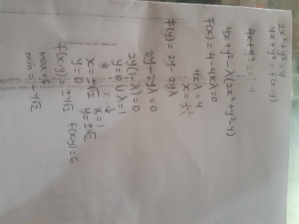

With Lagrange multipliers i only get one critical point. How to get the other critical point?

what "to solve for y in the constraint" means?
Why Lagrange Method only gets me 1 critical point?
It gives you one value of x, but that corresponds to two y values.

I solve for y in the constraint and substitute it to y at f(xy). Gets me x = 4. But how to find y? I get y = undefined
About Lagrange Method, i get 2 y that is ##\sqrt{1/2}## and ##\sqrt{6/4}## but the answer it's wrong..

x = 4 is obviously wrong. Any point (x, y) has to lie on the ellipse ##2x^2 + 4y^2 = 4##.
Please show what you did to solve for y in this equation.
That's wrong as well. For an example of how to use the technique of Lagrange Multipliers, see https://en.wikipedia.org/wiki/Lagrange_multiplier, examples 1a, 1b, and 2.

So Lagrange Method is to find major x-axis only? I can't find minor axis?
Did you look at the link I wrote in post #9? In it there are several examples of how to use Lagrange multipliers, but you don't need to use that technique in this problem. I mentioned another way back in post #2.

I don't have to use Lagrange because the critical points can be seen in the ellipse? That is the x of vertices and the x of end points of minor axis?
So these are the critical points to test
X1 = 1
X2 = 0
X3 = +-##\sqrt2##

So. The 3 method mentioned. At least 2 method applied to get all the x.
Because using differentiation only gets me x=1
And using ellipse graph only gets me x=+-##\sqrt2##
By Lagrange only gets me x = +-##\sqrt2##
But by the Lagrange doesn't give me x=1?

x = 1 and x = ##\pm \sqrt 2## are critical points, but x = 0 is not.

If you use Lagrange multipliers correctly, it does give you x = 1.

What is the other method besides Lagrange and without inspection? Since i have to find max and min.
Because Lagrange gives me x=1
Differentiation gives me x=1

x = 1 indeed produces 2 y values. That is ##+-\sqrt2## and both of the y's give the same value for f(xy) that is 6. Don't you agree?
While the end points of interval that gives you different value for f(xy).
This is Lagrange. And i was wrong before. You're right that it does give you x=1. But also x =+-##\sqrt2## don't you agree?
246139
I agree, but you shouldn't write f(xy) if you mean f(x, y). The first is a function of one variable (the product of x and y); the second is a function of two variables.
I don't agree that Lagrange produces ##x = \pm \sqrt 2##.
Lifeforbetter said:
The image you uploaded is rotated, and there is a crease running down the page about 1/3 of the way over from the left margin. These make what you wrote difficult to read in places, and impossible to read in some others. Everything you wrote can be done directly in the input pane using LaTeX. There's a link to our tutorial at the lower left corner of the input pane.
##2x^2 + y^2 = 4##
##4x + y^2 = f(x,y)##
##4x + y^2 -\lambda( 2x^2 + y^2 - 4 )##
F(x) = 4 + ## -4\lambda x## =0
x = ##\frac{1}{\lambda}##
F(y) = 2y ##-2\lambda y## = 0
y = 0, ##\lambda## = 1
x = 1 -> y=+-##\sqrt2##
y = 0 -> x=+-##\sqrt2##
