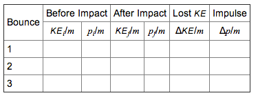

I believe I need to find these values in order to calculate the kinetic energy before and after impacts, and finding linear momentums - I have to fill out a chart like this one for seven bounces:
I also have no mass for the ball, p is basically equal to the velocity. And I am told that PE must be equal to KE of the ball at the beginning and at the end of each interval of free flight.

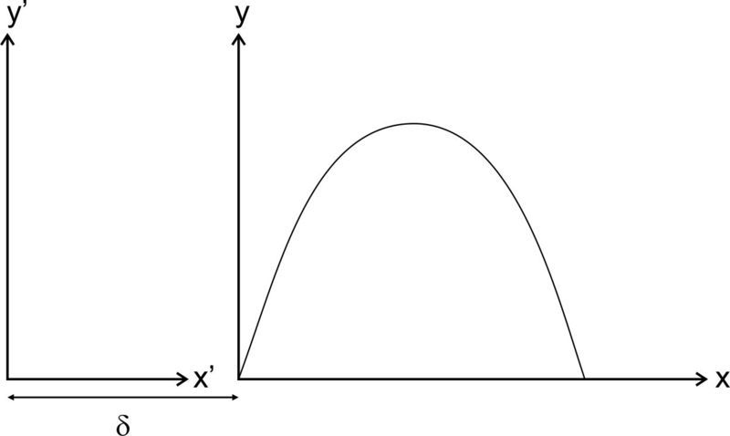

y = Ax + Bx2
y = y'
x' = x + δ
∴ x = x' - δ
Rewrite above equation using this relationship between the two variables
So the B value would stay the same?
It seems so yes.

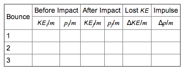

And THEN I have to do this:
Using the maximum height of the ball, it should be possible to calculate its maximum potential energy (PE) in the middle of each interval. From the principle of conservation of mechanical energy, this must be equal to the kinetic energy (KE) of the ball at the beginning and at the end of each interval of free flight. Therefore, you should be able to calculate the kinetic energy per unit mass (KE/m) just before and just after each impact with the ground. The momentum per unit mass (p/m) can also be calculated just before and just after each impact. Note that this quantity is basically equal to the ball’s velocity.
After showing detailed sample calculations, construct a table similar to the one shown below, in which you include the changes in the kinetic energy and momentum as a result of each impact. Note that the momentum is a vector quantity, and therefore, the sign is very important.
And this is where I'm trying to get the velocities... unless I don't have to and just use the B values. But I'm getting numbers that do not make sense to me.
You can't use the B values for the reasons given: they do not represent velocities all at the same height.
I knew it was simpler than what I was doing!
Okay, so since I have max. heights for each of the bounces, I can find PE as g*h. So before impact, KE = PE. After impact, KE would be the PE of the following bounce, correct?
And since momentum is the velocity in this case (no mass was recorded), it would be:
1/2 mv^2 = mgh
v = sqrt 2*g*h
Am I correct in my thinking here?
1/2 mv^2 = mgh
v = sqrt 2*g*h
Yes, that's all correct. Btw, in the graphs, something odd seems to have happened between the third and fourth bounces. It looks like the sensor got knocked down a bit.
