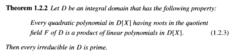

I need some help with the proof of Theorem 1.2.2 ...
Theorem 1.2.2 reads as follows:

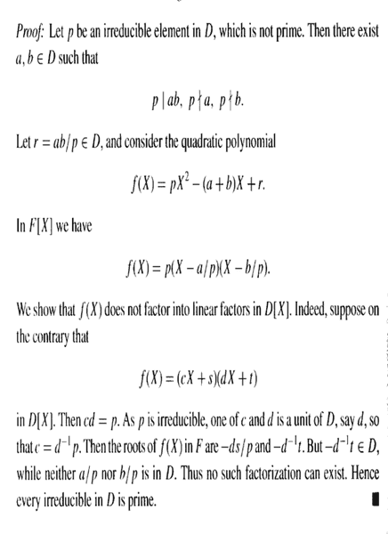

In the above text from Alaca and Williams, we read the following:
"... ... Then the roots of ##f(X)## in ##F## are ##-ds/p## and ##-d^{-1} t ##. But ##d^{-1} t \in D## while neither ##a/p## nor ##b/p## is in ##D##. Thus no such factorization exists. ...I am unsure of how this argument leads to the conclusion that ##f(X)## does not factor into linear factors in ##D[X]## ... ... in other words how does the argument that " ... ##d^{-1} t \in D## while neither ##a/p## nor ##b/p## is in ##D## ... " lead to the conclusion that no such factorization exists. ...
Indeed ... in particular ... how does the statement "neither ##a/p## nor ## b/p## is in ##D##" have meaning in the assumed factorization ##f(X) = (cX + s) ( dX + t )## ... ... ? ... What is the exact point being made about the assumed factorization ... ?
I am also a little unsure of what is going on when Alaca and Williams change or swap between ##D[X]## and ##F[X]## ...Can someone help with an explanation ...

We have ##0=f(-d^{-1}t)=p(-d^{-1}t-a/p)(-d^{-1}t-b/p)## in the field ##F##. What does this mean for the factors?

##f(x)=p(x-\frac{a}{p})(x-\frac{b}{p}) \in F[x]## is simply set. It's a polynomial that is chosen on purpose. Since the condition (1.2.3) applies to all quadratic polynomials in ##D[x]##, it also applies to ##f(x)=px^2-(a+b)x+\frac{ab}{p} \in D[x]##. ##f(x)## is in ##D[x]## because ##p,a,b,r=\frac{ab}{p}## are all in ##D##.
The factorization ##f(x)=(cx+s)(dx+t)## in ##D[x]## is the assumption we want to show cannot hold. It leads to ##d^{-1}t \in D \;\wedge \; d^{-1}t \notin D## which is obviously false. Thus ##f(x)## doesn't split over ##D##. But according to condition (1.2.3) it has to split over ##D##. Therefore ##f(x)## cannot be in ##D[x]##. But the only way, that ##f(x) \notin D[x]## is by ##r \notin D##. But then ##p \nmid (ab)##, which means ##p## isn't irreducible and non-prime. Since ##p## is chosen irreducible, it has to conflict the other property, being non-prime, which was our first assumption. But non-non-prime means ##p## is prime, what had to be shown.

Thanks fresh_42 ... really appreciate your help ...
... BUT ... just a clarification ...You write:"... ... It leads to ##d^{-1}t \in D \;\wedge \; d^{-1}t \notin D## ... ... "I can see that ##d^{-1}t \in D## ... ... since ##d## is a unit of ##D## we have ##d^{-1} \in D## and also we have ##t \in D## ... so ##d^{-1}t \in D## ...But in what way do we show that ##d^{-1}t \notin D## ... ... ? How do you argue that ##a/p \in D## ... ? Don't Alaca and Williams only argue that ##a/p \in F##?
So one factor has to be zero. Since ##p\neq 0##, w.l.o.g. (the argument in the other case is the same) ##d^{-1}t = -\frac{a}{p} \notin D## because ##p\nmid a## in ##D##.
