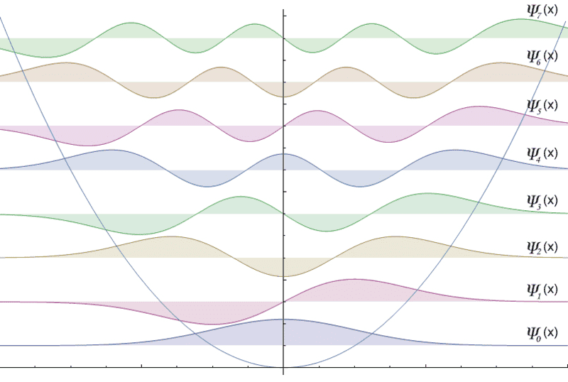

Hello everybody, recently in my quantum mechanical course we were introduced to the concept of the quantum harmonic oscillator. My question is: is there a physical significance attached to the fact that the classical turning points overlap with the sign change of the second derivative of the quantum mechanical wavefunction (which in turn occurs where the wavefunction intercepts the potential curve)? That is both geometrically and algebraically it is easy to see that these points will be the same for all states (ground state and all excited states) but can this be interpreted physically somehow? As you can see in the picture below, the quadratic/parabolic/harmonic function intersects each wavefunction at an inflection point where the concavity of the curve changes (which indicates a change in the second derivative of the wavefunction at that particular point).

It might be a trivial question or this might not have a physical significance at all, but anyway it troubled me and my lecturer as well, who said that he had never thought about that. I haven't given much thought about it either, nor have I settled down to play around with the maths of it, but if any of you has a clue as to which direction I should be heading towards that would save me much valuable time.

P.S. For some odd reason I can't manage to incorporate the image in the text using an image hosting website. Find it attached or simply google it, sketch it, look it up in a book or your notes. It's just a casual random quantum harmonic oscillator potential and wavefunction plot.

Schroedinger's (time-independent) equation is: [tex]\frac{-\hbar^2}{2m}\frac{d^2 \psi}{dx^2}+V(x)\psi = E\psi[/tex]
One can see that from the equation, it's quite obvious that the second derivative will change signs where E=V, which is exactly the classical turning points.
I'm not sure what more you want?
Both geometrically and algebracaly the case is pretty obvious. What I am asking again is if this fact has some sort of physical significance. Does it represent something or is it some sort of restriction upon something? That king of thing, if this is any more helpful...
These points represent the points beyond which the kinetic energy operator changes sign and has negative expectation value. Is that "something physical" that you're looking for?

Wait what? Within the same line system it represents that, but what does that physically mean or what does it mean from intersection to intersection? If the sine changes that's where it oscillates in a way where based on evolution through time you would have a high or low probability of measuring it in a specific location? Or, why does the x-value distance between those intersections from system to the next system seem to decrease?
