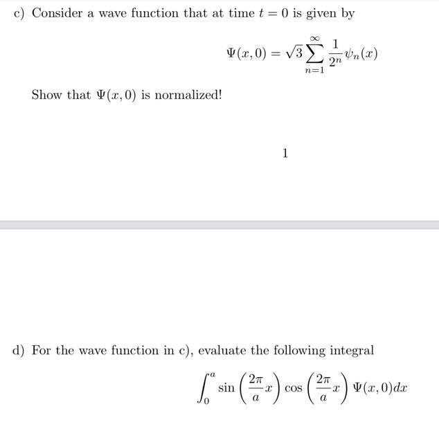

I have solved c), but don’t know how to solve the integral in d.

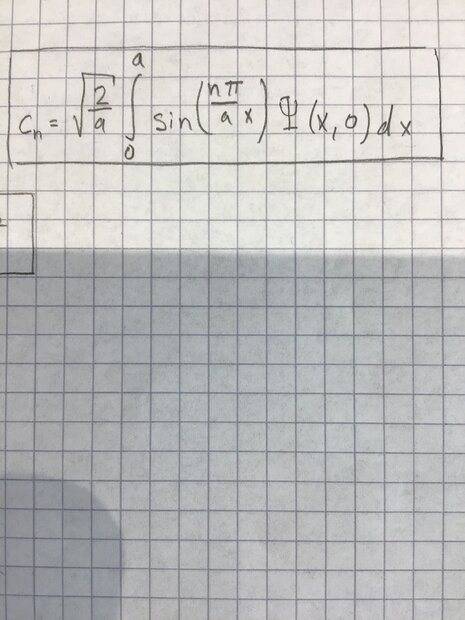

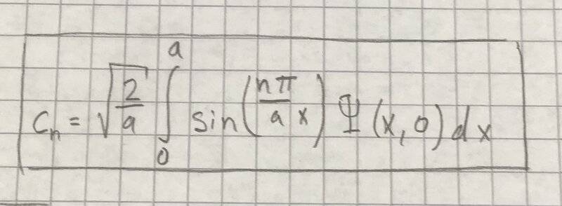

It looks like an integral to get c_n (photo below), but I still can’t figure out what to make of c) in the integral of d).

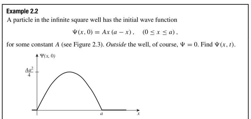

I also thought maybe you can rewrite c) into an initial wave function (photo below) with A,x,a but don’t know how.

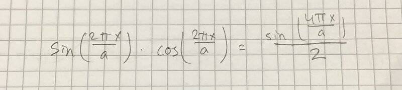

Consider using a trig identity to write ##\sin\left(\frac{2\pi}{a}x\right)\cos\left(\frac{2\pi}{a}x\right)## in a way that will be helpful in evaluating the integral.

I tried like this already, but I still don’t know how to deal with c) in the integral.

OK, good. Can you relate ##\large\frac{\sin\left(\frac{4\pi x}{a}\right)}{2}## to one of the ##\psi_n(x)##?
Likes Graham87 and Delta2
ψ4(x) ?

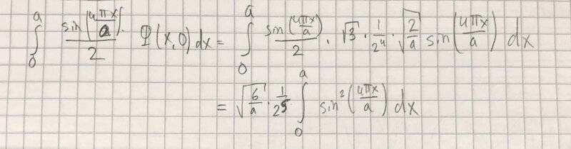

So like this?
I found the integral d) similar to this.
Is it wrong to assume that c_4 should be the same as my answer in d)?
In that case my answer in d is not correct.
You're asking, are
$$\frac{\sqrt{2a}}{4} \int \psi_4^2\,dx$$ and $$\int \psi_4^2\,dx$$ equal? I think you should be able to answer that on your own. :)
Likes Graham87
You need to calculate ##\int_0^a{\sin\left(\frac{2\pi x}{a}\right)\cos\left(\frac{2\pi x}{a}\right)}\Psi(x,0)dx##
Write this as ##\frac{\sqrt{2a}}{4}\int_0^a\psi_4(x)\Psi(x,0)dx##.
Substitute the given expression for ##\Psi(x,0)## and evaluate using the orthonormality of the ##\psi_n(x)##.
You should get the same answer as you got in post #7.
