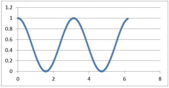

The graph attached may be of help in determining that average value.

To get the average power, we can use the relationship given in the problem:
##<cos^2(kx-\omega t)> = \frac{1}{2\pi} \int_0^{2\pi} \cos^2(kx-\omega t) d(kx-\omega t)##
##<cos^2(kx-\omega t)> = \frac{1}{2\pi} \int_0^{2\pi} \frac{1}{2} (1 + \cos(2(kx-\omega t))) d(kx-\omega t)##
##<cos^2(kx-\omega t)> = \frac{1}{2}##
