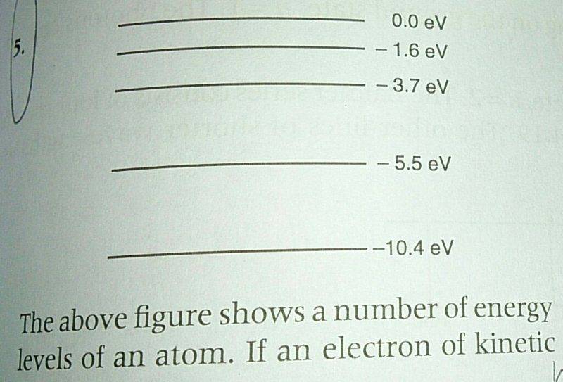

since the bombarding electron has only 7.0eV ... it's not sufficient for the electron in the ground state to be excited which needs 10.4eV , so no excitation occur. and in my opinion, the bombarding electron should emerge with the same amount of energy ... but the ans given is here different . Can somoene explain what's the ans is about? thanks! [/B]
SAMPLE ANS : 7.0- ( (-3.7eV) - (-10.4eV) ) = 0.3eV...
The picture does not show what the question is.
You cannot discuss the answer unless you know the question.:)
Sorry.. The question should be
If the kinetic energy of an electron 7.0eV collides elastically with an atom in ground state , what's the kinetic energy of the elctron after collision? Ps I forgot to post the question...
It need 10.4 eV to ionize the atom but not to excite it.
The atom can go from the ground state to one of the other states in the diagram. This transition will require less than 10.4 eV. Which transitions are possible in this case?

-10.4eV to- 5.5eV , -10.4eV to -3.7eV are possible
What will be the KE of the initial electron after each of these two processes?
Likes desmond iking
for -10.4eV to- 5.5eV , using ke= hf-W
i have ke= 7.0eV - ( 10.4-5.5) = 2.1eV
for -10.4eV to -3.7eV , i have ke= 7.0eV - ( 10.4-3.7) =0.3eV

So what did you find in the previous calculation? Were not these values of kinetic energy after collision?
