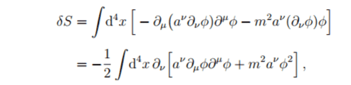

Hi,
Please see attached.
I am trying to show the second equality , expressing all as a total derivative (I can then show that ##\delta S = ##)
See above
So the ## m ## term is pretty obvious, simply using the chain rule.
It is the first term I am stuck on. So looking by the sign, it looks like we have done integration by parts twice.
My working so far is to go by parts initially as:
##w=\partial^{u}\phi ##
##\partial w = \partial_{v}\partial^{u} \phi ##
## \partial z = \partial_{u}\partial_{v} \phi ##
## z= \partial_{u} \phi ##
to get, since we are allowed to assume vanishing of the field ##\phi ## at inifnity:
## - \int \partial_{u} \phi ( \partial_{v} \partial^{u} \phi ) ##
I am now stuck of what to do, I can't see a move that will get the desired expression for a choice of integration by parts, which makes me question whether this was the correct first move to make.
Many thanks in advance.

Is ##a## constant? It is just the same type of relation as the mass term. Just switch the order of the derivatives.
The ##\partial_{u} ## is not hitting the ## \partial^{u} \phi ## though?
I have the first line as ## a^{v}\partial_{u}\partial_{v}\phi \partial^{u} \phi = a^{v}(\partial^2 _{uv} \phi)(\partial^{u} \phi )##,
whereas I have the bottom line as ## (a^{v}\partial^{2}_{uv}\phi)(\partial_{v}\partial^{u} \phi) ##..

No this is not the bottom line - it does not contain four derivatives ... Just use the same argument as for the mass term, or more generally ##f\, df/dx = 0.5 df^2/dx##.

I don't get your meaning. Both the bottom and top lines have two terms. One from the mass and one from the kinetic term.

Is your problem that you do not see that
(\partial_a \partial_b \phi) (\partial^a \phi) = \frac{1}{2} \partial_b [(\partial_a \phi)(\partial^a\phi)] ?

The kinetic term has one term only in both lines in your OP.
oh right got it !
by two terms I was reffering to the product rule, but then you sea-saw giving the factor of ##1/2##, thank you !
