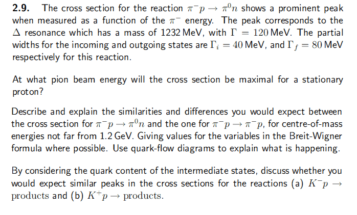

(a) Find energy of incoming beam that creates highest cross section
(b) What are the differences in the two reactions, using quark diagrams?
(c) What would the peaks of the two reactions be like?

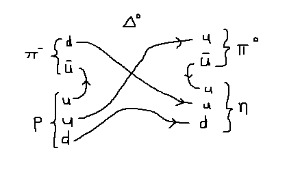

First reaction is given by: ## \pi^{-} + p \rightarrow \pi^0 + n ## and quark flow diagram is shown:

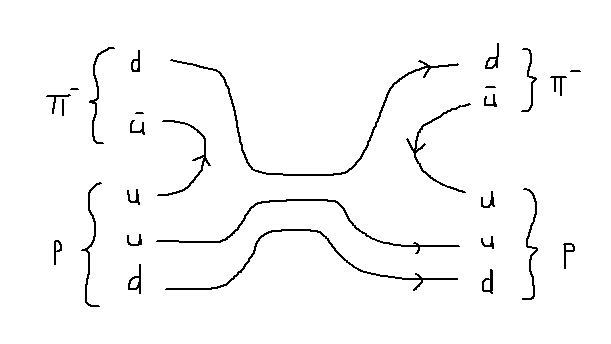

The second reaction is given by: ##\pi^{-} + p \rightarrow \pi^{-} + p## and quark flow diagram is shown:
I'm not sure how the reaction would be different. I'm guessing reaction 1 would be more favourable, since the products are lighter?
There is a wrong quark label at your outgoing neutron.
The mass differences between the pions are small and the differences between proton and neutron are even smaller (and in the opposite direction), I would not expect a significant effect from that.
The second reaction has more options how it can happen, but I don't know how relevant that is.
