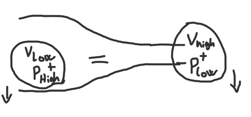

What happens to a vacuum ejector if the pressure drops
I have a vacuum ejector and with a suction cup that drops items. think maybe it could be a pressure drop. but what happens if a vacuum ejector gets less pressure, does it suck less? know it's something with bernoulis
If the pressure decreases, the total energy must decrease and thereby the principle of conservation of energy can be used
If you mean "does a suction cup suck less when atmospheric pressure decreases" then yes.
If you're at seal level you have ~14psi pushing against the cup from the outside. At 20,000 feet altitude, less than that : ~7psi.
Technically of course the suction cup isn't sucking, the atmosphere is pushing.
A vacuum ejector run on compressed air and I wonder if it falls. and the explanation for that.

I'm still having trouble finding a spicefict place it says it. After looking several times.
"Yes, less working pressure leads to less useful vacuum."
Not just correct, but precisely correct. Kudos, sir! (color emphasis mine).
