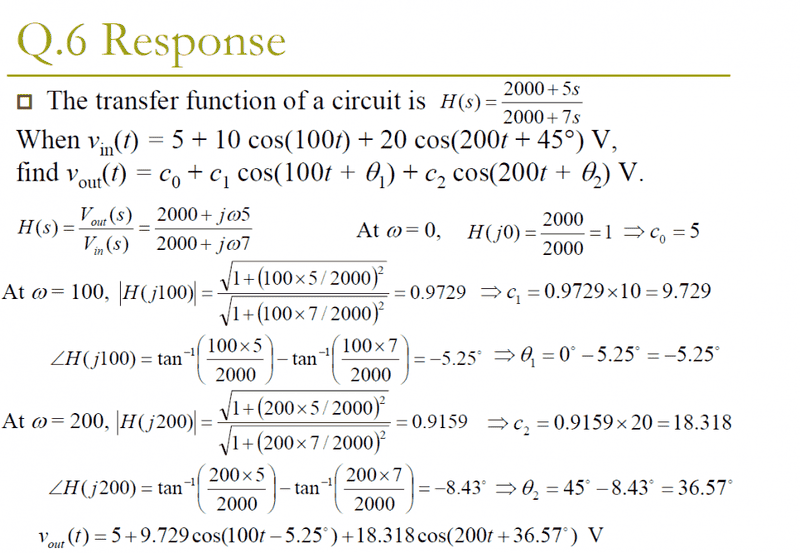

whu at w=100 the effect of c0 and c2 will not count
also w=200 the effect of c1 and c0 will not count?

Well, it's a worked out example and OP wonders about the coefficients. The reason is that this is all about linear systems, and one property of a linear system is that you can write the total response as the sum of responses to the individual frequency components in the input.
And an input of a particular ##\omega## can only lead to a response with that same ##\omega## plus its very own ##\theta##.

got it thank
