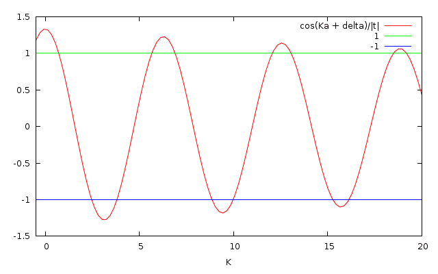

The graph I was talking about in my book is like this:
The top and bottom lines are just 1 and -1 to show that the values of K that make the curve go above and below them (respectively) can't possibly make that equation true, so those ranges are the band gaps.

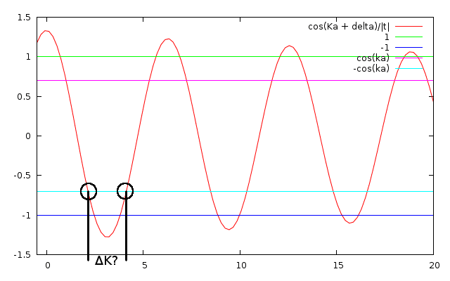

So, just to make it explicit so I'm sure: If we want to find the band gap for one distinct value of ##k##, I would draw a line across this graph at ##\pm cos(ka)## and find the intersection with the curve. This would give me the values of ##K## corresponding to this ##k##, and then these are easily turned into ##E##'s, like so:
Is that correct?

No, that is not the correct ##\Delta K## (##= K_1 - K_2##). That ##\Delta K## corresponds to range of energies ##\Delta E = \hbar^2 K_1^2/2m - \hbar^2 K_2^2/2m## that are allowed in the dispersion relation. You want to determine the ##\Delta E## for which the states are forbidden. That region will correspond to consecutive intersections of the red curve with the cyan line only or the purple line only; NOT the region between the intersection of the red curve with the purple line followed by the intersection of the red curve with the cyan line.
But then what value of ##k## should you use? For each ##k## you will get a different ##\Delta K## (or ##\Delta E##). The band gap is defined as the ##k## for which ##\Delta E## in minimum. In this example, this point will occur at the edge of the Brillouin zone. In this example, ##k = 1/2 \times 2\pi/b##, where ##b## is the size of your unit cell. Since you mentioned that the (barrier region) ##V(x) = V_0## region has a width ##a## and the ##V(x)=0## region also has width ##a##, your unit cell size will be ##b=2a##. Therefore you should find the gap at ##k = \pm \pi/2a##.
You should recheck your expression (more specifically your RHS where I think you might have ##\cos(2ka)## instead of ##\cos(ka)##). For ##k = \pm \pi/2a## the RHS will be zero. In other words, your two horizontal lines will collapse onto each other.

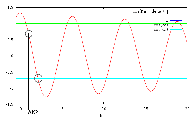

Ahhh of course, that makes sense. Sorry, stupid of me. So the first ##\Delta K## that determines the ##\Delta E## should be:
So, you're saying that the ##k## at which ##\Delta E## is a minimum will be at the ##k## that makes the argument of the RHS biggest, i.e., 1.

Yes, the ##\Delta K## you've shown in the updated figure is correct.
Yes, if you do it the numerical calculations correctly you should get the exact solution. Now, comparing the exact solution to the perturbative one is a little tricky. In the Kronig-Penney model, which is discussed in the document I sent earlier (more like pasted the link to it), you treat the periodic potential as strong.
