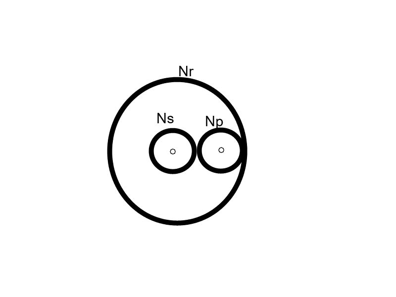

Machine design texts frequently provide formulas of the sort you are looking to find. You can also work it out for yourself simply by writing the relevant kinematic constraint equations.
mrhall1923 said:
My question is about having a fixed planetary gear carrier (Ty) with the ring gear being the input and the sun gear being the output.
I think this is correct..
Let Nr, Np, Ns be the number of teeth on the ring, planet and sun gears.
For each turn of the ring the planets rotate (about their fixed centre) Nr/Np times.
For each turn of the planets the sun rotates Np/Ns
So for each turn of the ring the sun turns:
(Nr/Np) * (Np/Ns) = Nr/Ns

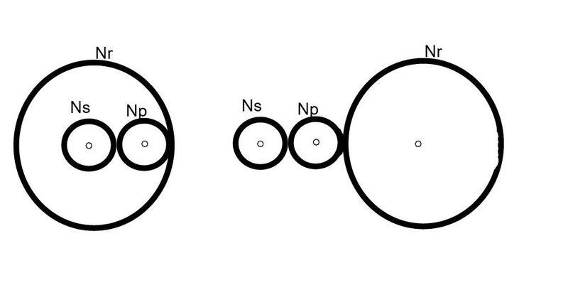

Edit: In case it's not obvious, these two set ups are equivalent (except for the direction of rotation).
