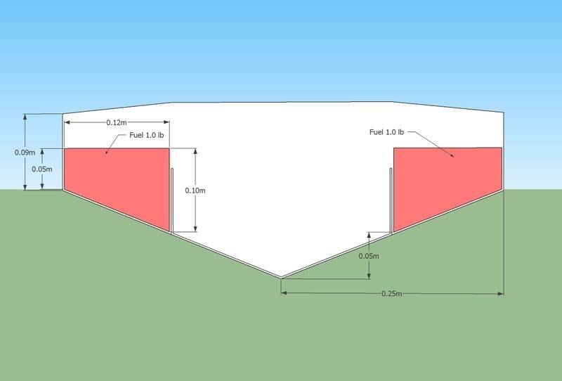

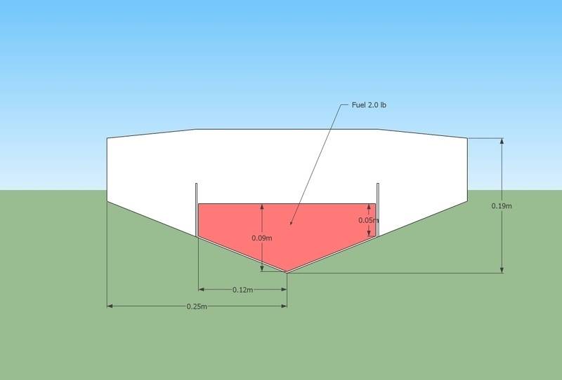

I have uploaded drawings of two "speed boats" with fuel systems.
Which boat got the best CG?
The one with one, or the one with two fuel tanks?
What do you think.

Best meaning lowest?
Well for the CoG weight is very important and missing in the pictures. Still i would say the first ( personal opinion, that has to come out).
Yes, I mean lowest! (Best stability.)
Everything is off course theoretical.
The weight of the boat is the same in both examples.
The weight of the fuel is also the same, 2 lb. (Small RC boat)
The area of one big tank is the same as the area of the two small combined, meaning length of all tanks will be the same.

In this case the first boat layout is best ( no more personals)
Cause the lower the fuel is the lower the CoG is.
Btw a 2 lb fuel tank is insignifiant considering that the boat is probably 100 times heavier.
Best to just make the fuel tank as you wish ( comfort and overall design where the second layout might be better) and sit in the boat in the lowest position as your 160 lb really make a difference.

Theoretically speaking, the first one(fuel being in the center) will be more stable than the second.
However, my answer could be wrong due to the fact that condition may be different on sea. Many other factors must also be take into consideration, one ought to study 'maritime engineering' to have a total grasp on it.

Consider also the resistance towards a rolling motion of the boat, caused e.g. by a wave pushing it up only on one side. The divided tank will provide more rotational inertia and the boat will be less likely to roll around its axis of motion.
A speed boat experiences very complicated/chaotic forces on an uneven sea. It's probably best to go for a tried and true design, so as not to cause any uneccesary risk. If innovation is not an important design goal, that is.
