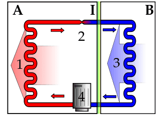

Don't any of your ME colleagues know how a refrigeration system works?
What you seem to be describing is what is known as the Joule-Thomson effect, which is used quite often in the cryogenic field to liquefy various gases:
https://en.wikipedia.org/wiki/Joule–Thomson_effect
In common refrigeration applications, the vapor-compression cycle is often used, but the refrigerant experiences two phases, saturated liquid and superheated vapor, during the operation of this cycle:
https://en.wikipedia.org/wiki/Vapor-compression_refrigeration

basically the bottle represent area 1.
the coolest part is right after expansion valve where the most pressure drop occurs. in your case it is right after the hole.
Another common example is CO2 fire extinguisher. You can easily find air moisture turns into frost around the nozzle.
