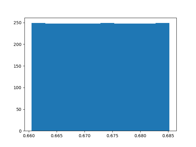

Its actually has the similar idea as your. The relationship between ##x## and ##a## is linear. So as we increase ##x## at some point it hits ##-\delta c## and another point it hits ##+\delta c##. The problem how can I calculate ##x## and ##\delta x## from the given data list.
This is the histpgram of the ##x## values.
Looks pretty uniform to me :smile:

So mean(x_values) and std(x_values) are the correct solution ?
According to the numerical example, mean would be ok, st dev would be too optimistic
Yes, I know. In the example I started with 2##\pm##0.2. The flat distribution gave a sigma of 0.13, about a factor of ##\sqrt 3## lower. Your procedure cuts at ##\pm\sigma## -- whereas a gauss distribution has , what was it again, 68% within ##\pm\sigma## and the remainder outside, contributing happily to the standard deviation.
