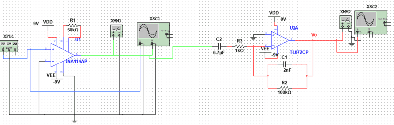

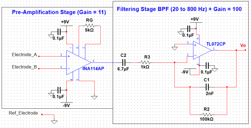

Hello
I'm working on project called"design & implementation of EMG data acquisition",after I search on these systems i really confused about what the gain and the filter type that i have to use.
at the first stage i use instrumentation amplifier to amplify the signal, so how much the gain of this stage should be? and i use Band-Pass Filter in the second stage which is eliminating the unwanted frequency components, which type of filter is suitable to get a very clean EMG signal? Is sallen-key or butterworth good enough for that? and how much should the order of filter be?
the attached image for my design for now in Multisim, I will add proper ADC to it...thanks...

You work from both ends to the middle. You need the peak voltage before your input amplifier. You need the input voltage specification for your analog/digital converter. Divide. That gives you the gain you need. Then you need the source impedance of your input signal, from which you calculate the minimum input impedance of the input amplifier.
Then you define the requirements of your filter. Allowable ripple in the passband, maximum allowable gain in the stopband, minimum range of passband frequencies, maximum range of stopband frequencies, allowable phase lag, allowable phase variation. That will give you the minimum rolloff (attenuation rate), from which you can find the minimum filter order. The gain, ripple, and phase specifications will determine the best type of filter.
A Google search using search terms analog filter had many good hits. The hits from Sensors Online and Analogue Devices (analog.com) are a good place to start.

Thanks for your response, the goal of my project is that after complete designing this system, I have to classified four different hand movements like up,down,right,and left, so could this possible with and INA114 "instrumentation amplifier" and 1st order band-pass filter ?
please, if you could see the screenshot that I've attached of my design and tell me if this good enough to reach the goal of different hand movements?
Both @jim hardy and @Tom.G told you that you must think of things beyond the schematic on your screen. Not all problems can be solved using only a schematic design tool.
I think you need more direct help from an advisor or a mentor rather than written questions/answers on the Internet. Are there teachers or other students there who can help you?

1. Make gain adjustable perhaps R1 a 5K rheostat?
That way if noise is overwhelming you can turn down the gain and look at it with the 'scope.
2. If noise is high try a driven shield as in fig 10 of that datasheet @Tom.G linked. (EDIT i thought he linked it - anyhow it's at http://www.ti.com/lit/ds/symlink/ina114.pdf )

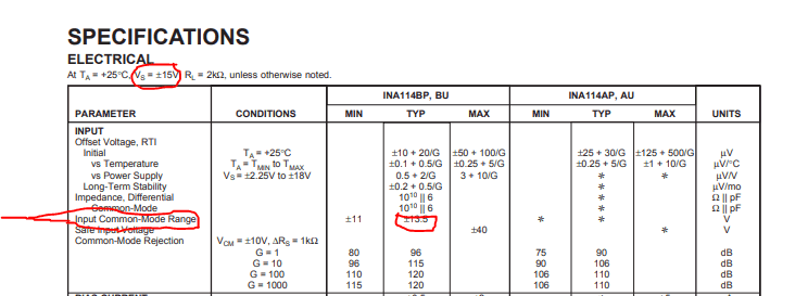

They're telling you right here that input voltage must remain a couple volts above V- and a couple volts below V+

I will supply the INA with + and - 9V and about the reference pin as in datasheet Is that mean I Should connect 5 ohm resistor to it ?
Good ! The junction of your +9 and - 9 volt supplies becomes "GND " ..

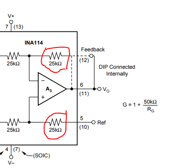

...and about the reference pin as in datasheet Is that mean I Should connect 5 ohm resistor to it ?
No, the datasheet is telling you that it takes only as little as 5 ohms to cause you trouble.
REF needs to be held at mid-supply voltage.
It is important that the two resistors i circled in red be very closely matched. Any resistance in series with REF pin adds to the bottom resistor making them unequal.
REF needs to be held near mid-supply voltage. Midpoint of your dual supply is the best place to connect it.
You would do well to master the "Difference Amplifier" for that's what A3 is. See http://hyperphysics.phy-astr.gsu.edu/hbase/Electronic/opampvar6.html#c3 , or any number of tutorials from a search.
and study figure 4 of the INA114 datasheet.

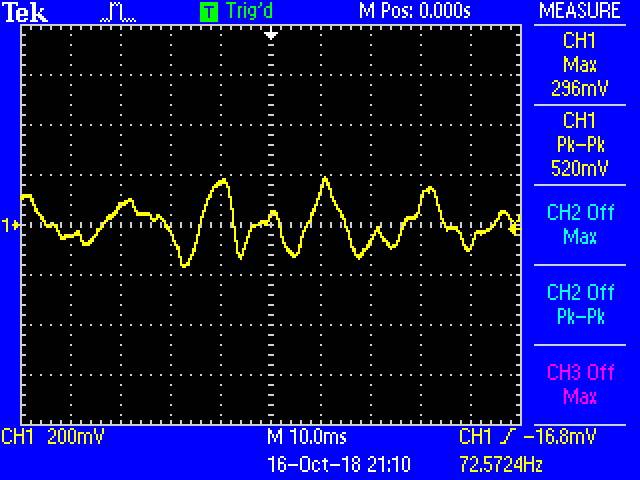

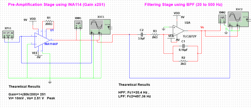

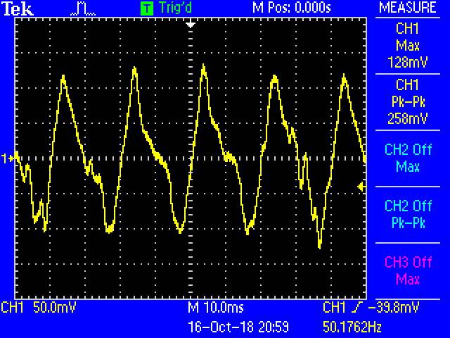

Hi @jim hardy
i connected the circuit (pre-amplification stage using INA114 + Filtering stage of BPF) and then connected the electrodes to my bicep muscle and try to detect some signal as shown in attached screenshots on the oscilloscope. I set the gain of INA to 2 "next time the gain will be 10" and the BPF has a gain of 100 and frequency band from about 20 to 700 Hz
I used the inputs of INA114 directly to the electrode with no isolation circuit ,Should I add isolation circuit or not since I supply my circuit with two 9v batteries?

Mo_Tuk said:
Hi @jim hardy
Looks mostly like 60Hz noise...

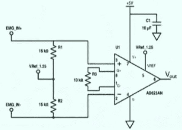

for the screenshot of INA, what the benefit of using two 15k resistors?
They look like they are just supplying the bias voltages for the two inputs.

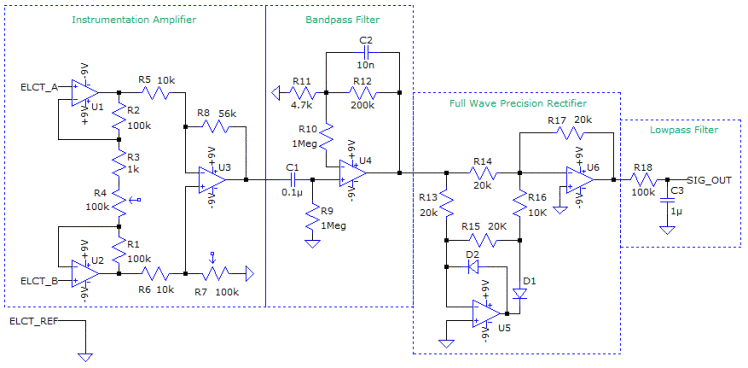

Can you post a diagram of your complete circuit, including the battery power supply, amp circuit, patient connections, and Earth Ground scheme?

I connected the circuit exactly as shown in screenshot:
If we're talking about the image attached to that post,
the two 15K resistors establish a reference that's halfway between the amplifier's supply voltage pins.
It's known as "virtual ground"
and if you're powering from two 9v batteries you could instead use for reference their junction.
nitpicking here - the noise is line frequency which for us is 60 hz but apparently for you 50 hz,
old jim
Likes Mo_Tuk

Thanks @jim hardy

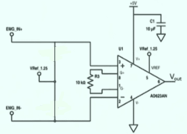

do you mean that I can just connect the circuit as shown in the screenshot below.
and about the 50Hz noise, How could I remove it ? and also do I have to add isolation circuit ?
I don't think you need it . You have no home-made equipment in between you and wall power that's likely to cause a short circuit. Your oscilloscope chassis should be tied to the the Earth grounding plug of your power cord. I would suggest check your outlet with an inexpensive receptacle checker, here's what they look like in USA :
Remaini aware you are relying on the internal insulation of any line connected equipment to protect you, so check it carefully for leakage current to Earth ground.
Not quite.
That screenshot shows a wire shorting out your signal. Take it out of your sketch and connect REF to power supply common.
old jim
Your circuit that you posted is very confusing for me. I asked to see the circuit that you said you connected to your bicep, but your schematic shows instruments, not a pair of patient connections as input. I also don't see Earth ground, and I see very different biasing compared to your latest differential amplifier questions.
Are you using a single 9V battery for power, or two to give you +/-9V? Please always show your power supply configuration in your schematics. What electrodes were you using to connect to your bicep? What brand, and how old are they? I assume they are single-use disposable, right?
When you flexed your bicep, did you see any response at all out of the amplifier string? It should have been much lower frequency than your 50/60Hz interference.
This is more like a circuit diagram that I would expect you to be posting...
https://greenhecktech.files.wordpress.com/2016/09/schematic4.png?w=748
Likes dlgoff and jim hardy

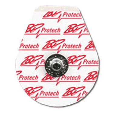

Yes, I'm using two +/-9V batteries to supply the circuit, and I used surface electrodes "BioProtech Electrodes" which shown in attached image.
Although the signal is 50Hz noise but when I flexed my bicep the amplitude increased but the signal still almost the same "50Hz noise"
Okay, there are two things that you should approach this with, IMO:
  • You should look more at shielding and balancing your probe lines to cut down on the AC Mains noise pickup -- if you post your full circuit diagram including Earth ground connections and shielding, we should be able to help with that
  • You should consider digitizing the waveform output from your circuit and doing DSP processing to filter out the AC Mains noise. You can do much higher order filters and adaptive filtering with DSP routines. Do you have experience with programming microcontrollers (uCs) in C or Assembly code?
Likes dlgoff, jim hardy and Mo_Tuk

Thanks @berkeman
I hope this screenshot of the circuit would be clear, and about the DSP part for now I just want to see clear EMG signal from my bicep muscle and then I will move to programming part using Arduino.
and about the electrode cables would you suggest any specific type of cable that less noise produced ??
