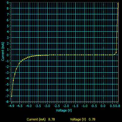

Saying "will not conduct" is a relative statement, not an absolute statement (at least not for real devices). There is a finite reverse leakage current before Zener breakdown, and as mentioned, the knee is not all that sharp.
Giving commercial zener diodes to students - they usually cannot detect the curve of the knee with equipment readily available in an undergraduate teaching lab.
OTOH: NZ colleges have pretty crappy equipment.
... this is more like what I see for reverse characteristics of a zener.
except I'm kinda used to seeing the sharp knee on the other side...
I mean: yeah sure you are correct. What you actually see depends on the application and the diode.
Reverse leakage current is always constant and stays that way before dielectric breakdown. However, Sandy Bridge's diagram is correct. The diode has a depletion region generation current flowing in reverse bias which gradually increases with bias. It is proportional to square root of applied reverse bias. Thus the reverse characteristics is not so sharp as it is thought to be.
EDIT: Opps It'll be Simon Bridge ! sorry
Look at the data sheet before you test the component. A typical BZX... 5V zener has a dynamic resistance of a few hundred ohms at 1mA reverse current, but 100 times less at say 50mA.
If you are only plotting currents up to 8mA, you are probably looking at the "off design point" part of the characteristic through a zoom lens.
Of course raising the current too far above the "design point" will kill the diode by exceeding the max power rating.
