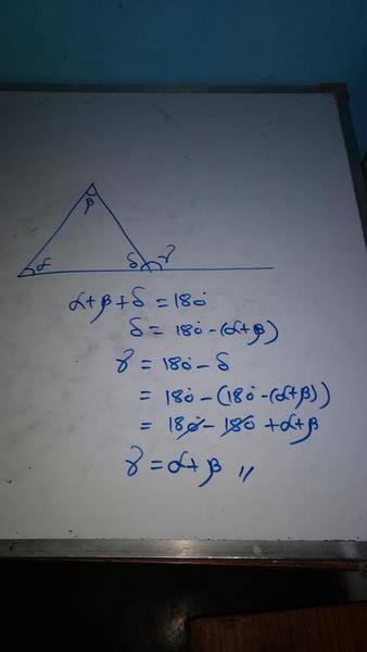

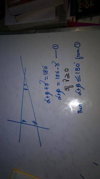

Why can't we prove euclids fifth postulate
What's wrong in this proof:

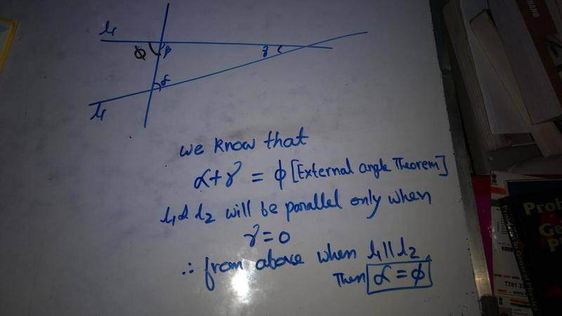

why can't we prove that there is only one line which passes through a single point which is parallel to a line.
If we can prove that two lines are parallel by proving that the alternate angles of a transverse passing through parallel side must be equal.
Then we could show that when a line throught that point behaves same then it will be parallel.
I know that euclids 5th postulate is unproveable and thus we have non-euclidean geometry, but i want to know what's wrong in my proof.

The external angle theorem, as you have stated it, is only provable if we assume the parallel postulate to be true. So your proposed proof of the parallel postulate is circular.
How?
Tell me Where did i used parallel postulate to prove exterior angle theorem.
Svein said:
When you say that the sum of the angles in a triangle is 180°.
So what do u want to say?
Let just stick to the euclidian geometry,
Then in euclidian geometry we can prove sum of angles of a triangle equals 180°
Because total angle of a straight line equals 180°.
What is wrong in my proof
So what do you want to justify, can't we prove total angle in a triangle equals 180° in euclidian geometry.
In elliptic geometry (https://en.wikipedia.org/wiki/Elliptic_geometry) the sum of the angles is >180° and in hyperbolic geometry (https://en.wikipedia.org/wiki/Hyperbolic_geometry) the sum of the angles is <180°.
I think you are right
Because in proving parallel postulate i used angle sum property of triangle and in proving triamgle sum property i have to use parallel postulate and thus its absured
When you say "Let's just stick to Euclidean Geometry", this is equivalent to assuming the Parallel Postulate. Euclid assumed the Parallel Postulate to be true. That's why it's called "Euclidean Geometry"

Since the OP's question has been answered and this debate started to create confusion rather than clearance, I close it.
In the case someone of the participants wants to start a discussion on non Euclidean geometries on Riemannian manifolds, please state all given facts at the beginning of a new thread. Here we have a simple Euclidean plane and classic geometry. No add-ons needed.
