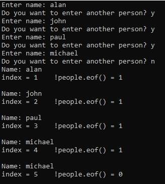

I put 3 out of 4 member components of the struct dataF person as comment to save typing. The struct only ask for name right now.
The first part is just writing as many person until I choose to end it. The second part of the program is to just print out all the person in the file. I enter 4 names, but when I read back, I read all 4 and repeat the last one before !people.eof()=0. As shown below:
You see I input 4 names, but when read back, michael is repeated twice. I print out the !people.eof() and you can see it's only after reading michael again before !people.eof() = 0.
I am sure it's my mistake, I just cannot see it. I put the read() inside the loop, I should get eof() after reading michael the first time.
BTW, other than repeating the last one, the program works with all the rest of the members that I put as comments.
thanks

Regarding your program in post #18, I think this is what is happening. Assuming there are N names in the file, the program can read the Nth name with no problem. It is only when we attempt to read from the file again that a read error occurs. When the call to people.read() fails, the output statement displays the previous value.
Here's a loop that works correctly.
C++:
while(true)
        people.read(reinterpret_cast<char*>(&person), sizeof(person));
        bool state = people.rdstate();
        if (state) break;    // If any of badbit, failbit, eofbit are set, state will be nonzero; i.e., true
        cout << " Name: " << person.name << "\n";
        index++;
        cout << " index = " << index << "    !people.eof() = " << !people.eof() << "\n\n";
When the call to people.read(...) fails, people.eofbit and people.failbit are set, so people.rdstate() will return true.

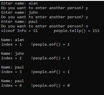

Thanks for the reply
But if you look at post 18, I actually copied the cmd window that I display !people.eof() and show it did not change to False until reading the Michael the second time. I don't think that's caused by error in reading.
I since added line 41 to display the size of the structure sizeof(Info). The sizeof(Info) = 51 bytes. Then I find the total bytes using people.seekp(0, ios::end); people.tellp() = 153 for 3 names. So that proofs I enter the correct number of names in the file and the file stored the correct number of names.

Here is the copy of cmd window after running:

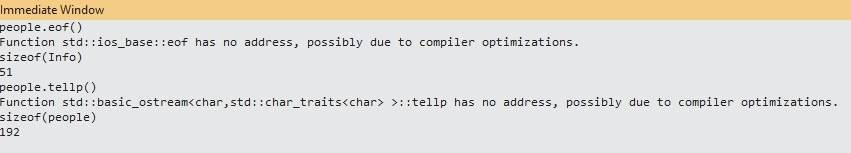

too bad there are things I cannot display in debug-->window-->immediate
I have to write that in the program on eof() and people.tellp(). I am having a ball with this debugger!

The double read persists even though it pass the if(!people) fail test. That is NOT the issue. I did this many times before I remove the few lines. Read the result, it shows eof() is not true until reading the paul the second time.
No, it doesn't read "Michael" a second time, it prints it a second time because you don't test whether people.read() has succeeded before you go ahead and print the last value that you read into person. The reason people.read() fails on the 5th pass through the loop is because it attempts to read beyond the end of the file (and therefore the subsequent call to people.eof() returns true).
Oh, you've changed your test data. No, it doesn't read "Paul" a second time, it prints it a second time because you don't test whether people.read() has succeeded before you go ahead and print the last value that you read into person. The reason people.read() fails on the 4th pass through the loop is because it attempts to read beyond the end of the file (and therefore the subsequent call to people.eof() returns true).
You are right, I put if(!people) to exit and it only print michael once.

BUT it's strange, if I replace if(!people.eof()), it failed the first time without printing anything!
I thought we should test for eof(), not fail. How do you know that?
I did not expect this can be a confusing issue, don't you read until eof()? In the example in the book, it only test if(!people) right after you open the file to make sure it open without problem. I thought from that onward, you only worry about eof().
Thanks
I don't find that strange: the ! is doing exactly what I would expect. Do you think it should be there?
Well testing for eof would work in this case, but there are other reasons a read can fail so you should always check that a read has worked before you assume that it has and press on regardless.
It is also good practice not to return out of a loop like this, instead of return use break and after the loop you can then test to see whether the last record in the file was read successfully or not.
Likes Vanadium 50 and yungman
  • #32
There is no error, it's the expected behavior. eof is set not when you've reached the end, but when you've tried to read passed the end. They should have named it peof (passed end of file).
Likes FactChecker, yungman and jtbell
