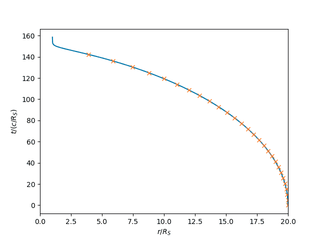

Here's a plot of the worldline of an infalling object in Schwarzschild coordinates:
Time goes up the page and the ##r## coordinate increases to the right. The event horizon would be a vertical line at ##r/R_S=1## in this representation (and the status of the graph to the left of that is a bit dubious, although that doesn't matter here). The object was released from rest at twenty times the Schwarzschild radius. It falls into the hole along the blue path with a clock whose ticks (at intervals of ##5R_S/c##) are marked as crosses. The sharp upward turn at the top left is where the gravitational time dilation begins to dominate and the downward progress (as measured in these coordinates) slows.
The blue line is a geodesic - it is straight. The reason it is shown as curved is because the lines of constant ##r## and lines of constant ##t## that would make a rectangular grid on this diagram are actually curved (they are not geodesics) and I've picked a coordinate system that renders them straight but bends the geodesic. But this coordinate system is pretty much the naive understanding of "space" and "time" and the weak field in these coordinates reduces directly to Newtonian gravity. That's why I picked these coordinates, and the curviness of the gridlines is why we see acceleration when we look at it naively.
I could pick a different coordinate system that straightens out the blue line (I think Gullstrand-Painleve coordinates do it, although that may only be for objects falling from infinity - I'd need to check). However, the price to be paid is that the ingoing and outgoing speeds of light are not symmetric and hovering clocks have a more complicated relationship to clocks at infinity.
