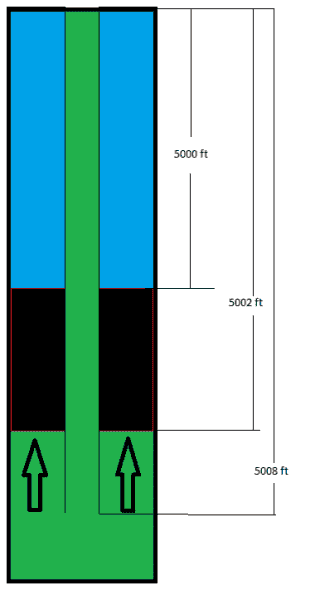

Ok so I'm an engineer and I ran into a physics problem the other day and I'm not quite sure how to go about it. I am very farmiliar with hyrdostatic pressures, but in this particular case I'm not exactly sure how the laws apply.
I have attached a sketch of my problem. There is an 18-3/4" ID main pipe. Inside of this pipe is a plug with a pipe running through the plug with a 6-5/8" OD and 4" ID. There are two water columns that are isolated from each other (The blue and green). The weights of the fluid are Blue = 10 lbs/gal Green = 9.8 lbs/gal
I know that the hydrostatic pressure of the blue fluid at 5000ft will be approximately (10 lbs/gal) x (5000 ft) x (.052) = 2600psi. I know this times the surface area of the top of the plug will give me the force acting downwards on the plug.
My question is in this scenario, what would the force acting upwards on the plug be? Because the smaller pipe opens up into the larger column of fluid how are the hydrostatic pressures affected. This would be like a straw on top of a swimming pool you can't measure the hydrostatic of the bottom of the pool off of the height of the straw.
I hope I have explained this well enough. Thank you in advance for anyone that might help!

How about 5002*9.8*0.052 ? (funny units, I'm sorry to say :) )
Yes, but that formula only works for solid columns of fluid. When the fluid changes from the smaller pipe to the larger pipe this is no longer true, so this would be true for the pressure at 5002 ft inside the smaller pipe, but not outside of it.
same depth, same pressure. So it does work. Communicating vessels and all that. If the pressure away from the axis were different, the liquid would flow towards the lower pressure. That's what it's liquid for,
Hmmm. so if I had a 100ft straw on top of a 2ft swimming pool the hydrostatic pressure in the swimming pool would be based off of the 102ft? Assuming the swimming pool had a top so the water couldn't escape.
No the straw would empty itself in the pool. If that's impossible, then: yes, the pressure in the pool would be about 4 Bar (ever heard of such sensible units ? 4 Bar = about 58 psi). The top would bulge unless very very very strong.
It's the principle of the hydraulic press , very useful!

So the hydrostatic pressure at the bottom of the tank would be based off of the height of the standpipe no matter what size the standpipe is?
Yep. That's Pascal's Law for you.

This is obviously a production or injection well operation. Is it an injection well? Are you sure that both fluids go to the surface and are open to the atmosphere at the surface? The reason I ask is that, in a real world well setting, that would not be the case. Also, if it were a real well, the fluid pressure in the injection/production string would not simply be hydrostatic. That would mean that the pressure difference across that packing would be different.
Is this really a homework problem or is it a real world well situation?
Chet
Chestermiller said:
Hi Tkopperl. Welcome to Physics Forums.
Chet
This is a real world scenario. You are correct, this is a model of a production well in 5000ft of sea water. The plug, actually a testing tool is used to test Blow Out Preventers. Both fluid columns are open to atmosphere. I was just curious about the U-Tube effect that happens.
