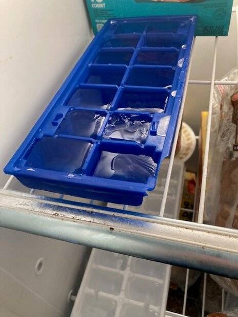

why is it, the ice cube tray freezes first, at the front of the tray closest to the door.
This should be the warmest place of the refrigerator. The back does not have enough time to send the colder air out to atmosphere.
I think i know the answer but lets us explore this..

I would GUESS better circulation.
How big is the refrigerator? The snowline is lower towards the pole. If you turn the unit 180°, so the door is towards the equator, you may find the opposite.

Partially - Mpemba effect with modification. We are not adding hot water to the ice cube tray, we are observing the effect however. Note -the front of the ice cube tray freeze before the rear of the tray!
I maintain that the refrigerator has a steady state until the door is opened. Then the hot air moves in seeking a lower energy state so the front of the refrigerator area is warmer. This area has the greatest temperature difference. The rear of the refrigerator is more or less stable due to the frozen food present there. The front only has the inside of the door which is a very poor heat conductor due to insulation. The same is true with top and bottom and sides. Poor conductors of heat. So instead of having water with warmer temperatures the front area of the refrigerator has the fastest freezing conditions due to warm air intrusion. Temperature is "heat density." Warm air contains more heat than cold air. When you open the door and air gets mixed up, you increase the heat density in the FRONT of refrigerator. Since the volume of the refrigerator is sealed ( has no entrance and exit portals) you do not have a mass of hot air rushing into the refrigerator. So the ice cube tray freezes in front before it freezes towards the rear.
Or did I miss sumthing???

I do not understand your argument. Why does “increase the heat density in the FRONT of refrigerator” imply “so the ice cube tray freezes in front before it freezes towards the rear”?

Maybe this is true for an old fashioned model but the two freezers I have owned recently (frost free) have forced air circulation and the specific layout of food in the drawers will have a large effect on the temperature distribution. Both front and back and top and bottom temperatures seem to vary very little. I notice, for example that ice cream in the bottom drawer is much more usable in my later freezer than it is in the earlier one so plain old convection is a secondary effect, perhaps.

I am convinced that the reason is often that warm water kicks the compressor into action earlier than a tray of cold water might. End product would be freezing earlier when the cooling cycle is designed to be long.
I suggest that the front/back effect could also depend on the placing of the thermostat. You'd need to do the experiment with small quantities of water, to be sure,

I have a bottom freezer (two-door) refrigerator and the air is actively drawn from the front of the freezer into the refrigerator just above the ice cube trays so the airflow depends upon a host of factors, most importantly how the freezer is packed. I will wager this "anomaly" has more to do with your reserves of ice cream and frozen corn than any physical process.

Bal, I respectfully disagree. There has to be a reason. You are on track regarding the position. Time to clear out the freezer shelf. Put two cube trays in ..same water, same temp. one tray up front, one tray in the rear.

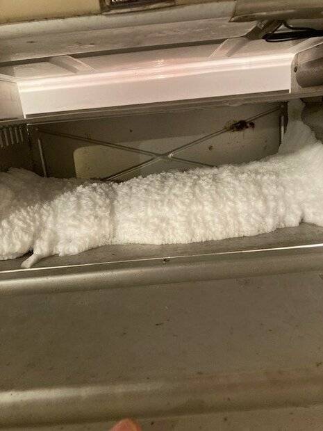

should i put aluminum foil on complete freezer shelf? It is wire shelf. also ice cube maker is off as from the start of this goat screw! ideas?

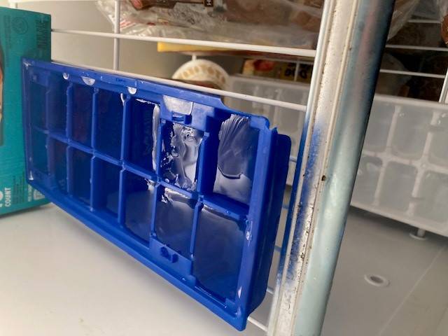

because the two inches of the front of the tray are freezing faster than the rest of the tray. All circulation occurs at the rear of the refrigerator. You think GE is going to plumb an air exchanger at the front? Both intake and exit ports are in the rear of the refrigerator. i stand by my posit of temperature gradient until some one can prove different...and I am not an expert. Ifin the cold air is coming in from the rear..why does the tray not freeze in the rear first?

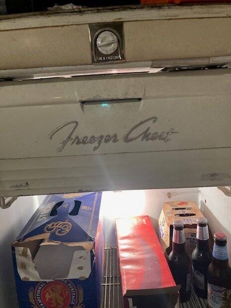

My GE refrigerator is 30 years old. What is fresh food section??? beer is cold..good to go..

This is a very hard problem to solve using your 30yr old refrigerator as the lab. There are so many factors that could come into play beyond what a student could possibly consider.

But the circulation pattern of the air within the compartment has a determination of water freezing at one location before the next. No way for anyone to know what is going on in there without adding in some sensors to record air movement and temperature. Otherwise a guess.
A guess:
Rear exit and entries provide an air movement within the compartment.
The cold air exit would blow towards the front, circulate around, and exit.
if the tray is in the centre of the compartment ie equal left and right distances:
the front of the tray would experience forced convection.
It could be that the air in the centre at the rear is rather stagnant, and here cooling would be not as robust as with force convection.
Try putting the tray completely to the left, or right and see what happens.
Put the tray the same height as the exit and see what happens.

evaporator fan.. this is why the front freezes first.
