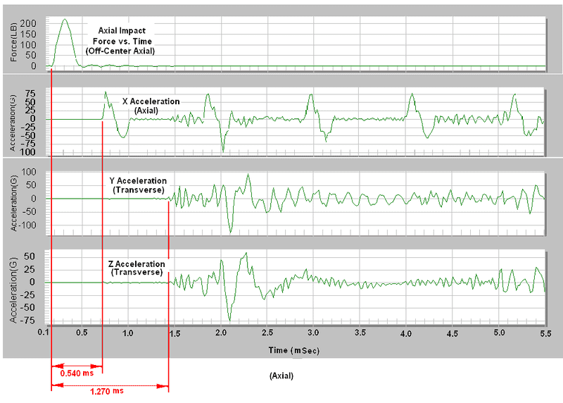

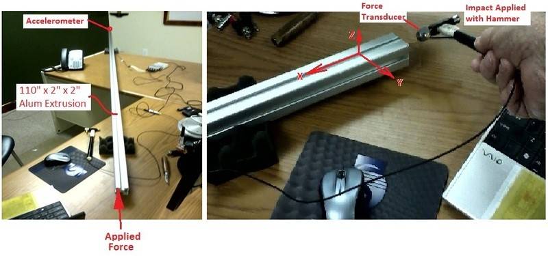

This afternoon I walked out in the lab and found a 110-inch aluminum extrusion with a 2" x 2" cross-section, set it up on my desk (two foam rubber supports for dynamic decoupling from desk). I attached a tri-axis accelerometer on the far end of the beam and applied a 0.3 milli-second force transient (approximate short half-sine pulse) to the other end. The force was applied to one corner of the beam end, hoping to get good excitation of the transverse modes of the beam as well as the longitudinal modes. A force transducer was attached to the hammer head. The force and accelerometer transducers were connected to a USB data acquisition module with parallel analog-to-digital conversion at 52.1 thousand samples per second. Here are plots of the four data channels. "As one would expect" the longitudinal pulse (axial) arrives before the transverse pulses.
The interpretation of the reflected pulses is not trivial--the normal mode theory must be applied with understanding of superposition principles, etc. The slight oscillations in the force signal following termination of the half-sine pulse is due to resonant vibration of the transducer-hammer head (the hammer continues to vibrate at very small amplitudes after losing contact with the beam). Maybe one of these days I'll repeat the test using a smaller diameter solid cylindrical rod with higher frequency response transducers (resonance freq of the accel was 50KHz) and lighter hammer head (shorter force pulse duration).
It took 0.540 milli-seconds for the initial stress pulse to travel from one end to the other. (By the way, the X-accelerometer was mounted with negative orientation, i.e., positive +G on the plot is actually -G, sorry).
Homework problem for LazerStallion: Compute the longitudinal speed of sound in this aluminum specimen.

Thanks for noticing, Simon Bridge. It was inspired by your excellent comments along with the others.

Got to thinking that there is no way the X-axis (longitudinal) accelerometer should respond with an initial negative going pulse, so double checked the polarity and found that the plot of Gx vs. time is correct as plotted. There was no error in the orientation of the accelerometer after all. Sorry for first sorry.
