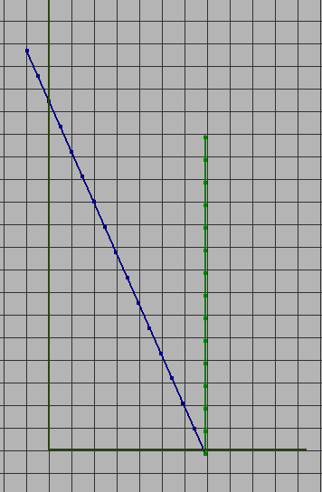

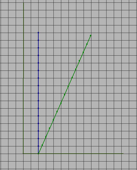

There is no contradiction. Your points 3 and 4 are superfluous. 1 and 2 are connected by a Lorentz transformation. I've attached two space time diagrams. The 'regular' frames of the two receeding onjects is plotted. The ticks on the worldlines are the clock ticks. Note that the ticks are spaced wider on the tilted worldline.
Mentz114 said:
There is no contradiction. Your points 3 and 4 are superfluous. .
My whole issue arises from calculation 3 and 4. My whole point is that it is not superfluous. So saying it's superfluous does not answer my question, when I am trying very hard to show that it is not superfluous.

If you swap 'My' with 'the other persons' they are the same - which is what the LT does - as the diagram shows.

On the ST diagram each observer sees the other clock apparently running slower in a symmetric way but the number of ticks remains the same.
Length contraction is a comparison between measuring both ends simultaneously and non-simultaneously. It has no physical significance.
