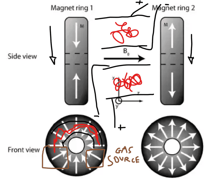

Is this design theoretically possible for electric energy production? Could be realised to be used to produce electricity?
According to the MHD theory, is case of energy production, a magnetic appplying a magnetic field to a moving charge perpendicular to the magnetic field, that could be plasma as well a solution full of ions, and placing two plates, electricity could be produced.
Now I have a question, let's say instead of moving the charges, the magnetic field is moved, in paricular in a circular motion with two ring
magnets
like in the image. Let's say they are ferrite magnets, so the intesity is kinda low respect to neudium magnets. These are made spin very fast, in the same direction. Now in theory by putting the a charge in between, and I though to fire, that is a plasma, and two plates.
Could this design produce a relevant amount of electricity? Could this work?
What is your energy source?
I'm not sure if I understand the concept, but it looks like you want to reproduce a generator - extracting electricity from the motion of the magnet rings? You get a force from a time-dependent magnetic field inducing an electric field, but the field here is time-independent.
Yes exactly, Normally in MHD generators the hot gas is shoot in between the fixed magnetic field, but what if the plasma, in this case fire from the combustion stays in that semi-ring, and the magnets over them spins, could this setup produce electricity? In other words could moving the magnetic field like this produce the necessary lorentz force to produce electricity?
There is nothing moving here (besides the field source). A moving particles in a magnetic field works: In the reference frame of the magnetic field you have the particle moving, in the reference frame of the particle the field transforms to have an electric field component. But here both reference frames are identical and you only have a non-moving charge in a magnetic field, assuming perfect symmetry in the setup.
