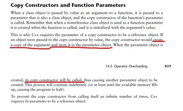

In operator overload I often see the parameter is always a reference parameter. I want to find out why. I read the Copy Constructor in the book. I want to verify whether I understand this correctly as it's really important. I use "xx" just to represent some operator like =, >> etc.
C++:
class ABC;
void operator xx (ABC & obj);
This is the copy of the two pages in the book explaining why and I had to read it quite a few times to understand it. I still want to verify here:
The way I understand it, if I write it like this
C++:
 void ABC xx (ABC obj)
, the operator function will first make a copy of the object of the RIGHT side of the xx and call it obj. But then when obj is first created, it will call the Copy Constructor and create another copy of obj(say called obj2), then when obj2 is created, it will call the Copy Constructor again and create another obj( called obj3) and it will keep doing it over and over until it bombed.
That's the reason it has to pass by reference so NO copy is created and no Copy Constructor will be called at this point.
This is the pdf of the Gaddis book, it's in Page 818 - 819:https://cplusplushelp.weebly.com/uploads/2/5/6/5/25655197/0136022537.pdf
Thanks

No, you're misunderstanding what you posted from the Gaddis book. This is about copy constructors, a type of constructor that creates a new object, not from scratch but copied from an existing object.
This has nothing to do with operators.
In the context of the code you posted, you would have something like this:

Thanks Mark, I am not asking about Copy Constructor, I am trying to understand why I see a lot of overloading operator function have argument that is reference to the object (Length&right) rather than the object(Length right) in the argument. for example
C++:
 Length L1, L2, L3;  L3 = L1 + L2;
where Length is a class.
The overloading operator is
C++:
 Length operator+(const Length &right)
If instead if I use
C++:
 Length operator+(const Length right)
, compiler will create object right and copy L2 into it, compiler will call Copy Constructor to initialize right. And then the cycle repeats creating a copy of right.
My question has really nothing to do with Copy Constructor, more WHY I have to pass the parameter by reference. Just happens that the book explain this in Copy Constructor.

If you weren't asking about copy constructors, then why did you post a screenshot of a section titled "Copy Constructors and Function Parameters" where you underline two phrases that were directly related to copy constructors?
The original title was also "Copy Constructors".
The fundamental issue appears to be call by reference vs. call by value as it applies to user-defined objects. And as Timo says, you don't really have a true call by value with objects. Operator overloading happens to be the use case here.

It seemed pretty clear to me that Gaddis was talking about copy constructors. If an overloaded operator needs to copy one object's values to another that needs to be created, then, yes, a copy constructor comes into play. But the main point Gaddis was trying to make was why a copy constructor needs a reference parameter, period.

I do not believe this is what Gaddis said. It's more likely that he was talking about a default copy constructor, one that is provided by the compiler, and that blindly copies everything over.

If you are talking about what you posted in post #1, you have completely misinterpreted what Gaddis said. He is not saying that it's bad to use a copy constructor -- he's telling you why the parameter needs to be a reference parameter rather than a value parameter.
And again, operator=() and a copy constructor are different things, used for different purposes. This is sort of like saying, "I rather use overloaded operator<<() instead of cout."
This is the reason I made this thread, the way the book described that the Copy constructor will go into an endless loop, can happen even on the other overload operators if their argument is (classtype ABC) if you have a copy constructor. Too bad that VS do not allow me to do this, it will flag error if I missed the &.
I did not start out drawing conclusion that Copy Constructor is bad in my original post, more a question about the importance of using reference &. The way the paragraph described, it can extend to other overloading operators that use (classtype ABC) without &. I want to try to understand this and this was my very question.
What is the advantage of using Copy Constructor that operator=() cannot do?
Thanks
No. Again, that is the wrong conclusion to reach -- that the three paragraphs can be extended to other than copy constructors. The first paragraph discusses how object parameters get passed to a function.
The second paragraph starts off,
This is why C++ requires the parameter of a copy constructor to be a reference object.
The main thrust of what you posted from Gaddis is about why the object parameter in a copy constructor has to be a reference parameter. It's a mistake to think that this requirement extends to all other functions or operators of a class.
It can be very frustrating to give you an answer in post #N, and have you ask the same question in post #(N + k,) with k > 0.
Please (re)read posts #9 and #14 carefully.
