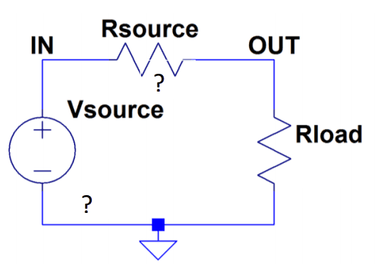

1. For the first measurement, a load resistance Rload = 119Ohms results in an output voltage V(OUT) = 11Volts. For the second measurement, Rload = 11Ohms results in an output voltage V(OUT) = 3.2Volts. From these two measurements, determine the output voltage V(OUT) when Rload = Rsource. You will have to first determine Rsourceand Vsource to answer this question. Express your answer in Volts. Note that the answers will not necessarily be consistent with any source we have seen but should not be unreasonable.

For the first problem, I knew that the greater Rload, the closer Vout would be to the actual source voltage. Thus I assumed that Vsource was 11Volts since 119 Ohms >> 11 Ohms. Plugging that in the equation where R1=R2, I got:
Vout = 11(R/2R) -> Vout = 11(1/2) -> Vout = 5.5 Volts.

This is what the circuit looks like for the first problem, by the way. As of now I have managed to figure out the second question but I am still struggling with this one.

You have 2 unknowns (Vsource and Rsource) so you will need to write 2 equations using the two data points (119R, 11V and 11R, 3.2V) and solve them.

Is that the only way to figure out the solution. Isn't there another way to find the output voltage by looking at the relationships between the resistances and voltages?
I checked my answer using your method, and it was correct. Thank you very much for helping me.
Yes your method might work because 119 Ohms >> 11 Ohms. That won't always be the case.
