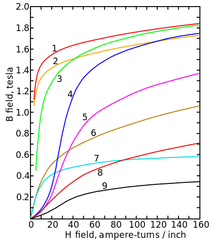

I've been informed also that an additional problem is that even with high current you run into the problem of magnetic saturation, where the magnetic field produced levels off:
https://en.wikipedia.org/wiki/Saturation_(magnetic)
But according to this wiki article the best you can get is with iron alloys at 2.2 T (Tesla). However, I've heard of cases of high intensity magnetic fields where you can get continuous, sustained fields significantly higher than this:
Orders of magnitude (magnetic field).
11.7 T 117 kG Field strength of a 500 MHz NMR spectrometer
16 T 160 kG Strength used to levitate a frog[14]
23.5 T 235 kG Field strength of a 1 GHz NMR spectrometer[15]
36.2 T 362 kG Strongest continuous magnetic field produced by non-superconductive resistive magnet.[16]
45 T 450 kG Strongest continuous magnetic field yet produced in a laboratory (Florida State University's National High Magnetic Field Laboratory in Tallahassee, USA).[17]
https://en.wikipedia.org/wiki/Orders_of_magnitude_(magnetic_field)
So how do they produce these high magnetic fields?
Bob Clark
