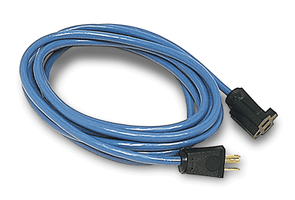

I have a home appliance that should be plugged into one single wall socket because it's energy consuming, and shouldn't share with other appliances by common sense. However, due to some practical problems, I can't plug it directly into the wall socket. If I use a power extension board (i.e. 1 to 2 or 3 or 4...) to serve as an intermediate, while all other sockets on the extension board are not used. Is it scientifically the same as it directly plug into the main wall socket?
The Power Extension Board my not be able to carry the current required.
Why not make up a short, dedicated heavy cable, extension cord to go between the appliance and the outlet?
Sorry I don't understand. Any pictures of example?
I don't know what a "power extension board" is, but a heavy duty extension cord looks like this:
https://www.waytekwire.com/images/items/10212FL.gif
