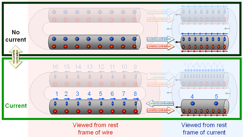

Now the problem I have with this is that if I turned off the current, this would imply that a stationary charge above the wire would experience an Electric force. Since the distribution of electrons in the wire would undergo a length expansion since they are no longer moving relative to the lab frame, as a result the wire should have a net positive charge and the stationary charge above the wire would experience an Electric force. But this is definitely not what we observe.

If you turn off the current the electrons in the wire will decelerate to rest with respect to the wire. What will happen to the different Lorentz contractions and the net charge then?
If the answer seems to violate the conservation of charge, you've probably forgotten to take the "return" wire into account. Current flows round a loop.

...if I turned off the current...the distribution of electrons in the wire would undergo a length expansion since they are no longer moving relative to the lab frame...
Length contraction describes the relation between different frames for the same situation, not between different situations (current off / on).
See this post by DrGreg with a great diagram:
https://www.physicsforums.com/showthread.php?p=4528480

Thank you, I think this is definitely it.
