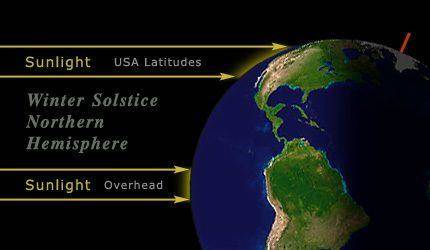

My understanding is that the seasonal variation in temperature, amongst many other things, is a reflection of the Earth's tilt.
Simply put, at the equator, sun rays fall "straight down" (100% vertical), and all of their energy hits the surface of the Earth. At different latitudes, these rays begin to have a horizontal component, so only the vertical portion (cosine of angle of incidence, I believe) hits the surface.
I assume this generalization also applies to solar panels: sun rays falling on the panel completely vertically will have more energy than those falling at an agle.
What would happen if you tilted your solar panel to match the sun ray's angle of incidence? Would it be just as effective in the middle of winter in Wisconsin (assuming no snow was on it) as in the summer in Ecuador?
Perhaps solar panels just don't work in the cold, even if high energy sun rays are falling upon it.

davenn said:
3. even with tilting the panels, the sun's energy at higher latitudes is still dispersed over a wider area than at the equator
decreasing the efficiency
No, that's just #2 repeated in a different - and slightly wrong implying - way. To be explicit: a 1 kW solar panel on the equator and perpendicular to the sun and a 1 kW solar panel in Wisconsin that is also perpendicular to the sun will both produce 1 kW.
This argument applies only if the light hits level ground. Not when it hits panels which are perpendicular to the light. What does affect light intensity though, is the different distance through the atmosphere.

davenn said:
have you some links to that please ? :)
Your photo shows it just fine. The two beams are the same width and contain the same amount of light, with the difference being that the light for the higher latitdue is spread-out over land that isn't perpendicular to the sun. So all you have to do is turn your detector to be perpendicular and it will catch the entire beam.
yes agreed, and I was assuming ( maybe incorrectly) that that is an important consideration between panels at equatorial regions and at much higher latitudes ?

To follow up on russ and davenn's sidepoint: is the light more "dilute" if it covers more area? Davenn's initial picture showed two illuminated areas, one at an equatorial region, one at a northern (tilted region). Also, each area is demarcated by two yellow lines. If the two yellow lines (at each illuminated area) are evenly spaced, would the light be more "dilute" at the illuminated area where more surface area is covered?
If distance through atmosphere is what you meant in post #3, then it was incomprehensible. Instead you were talking about a "wider area", even when the panels are perpendicular to the light rays. That doesn't make any sense.
There is only more surface area if the panels are not perpendicular to the light rays. If they are perpendicular, then distance through atmosphere is the only factor that differs between the latitudes.
AT: I see that now, and agree.
Is the decrease in energy as the rays go through more atmosphere negligible, or a pertinent factor?
